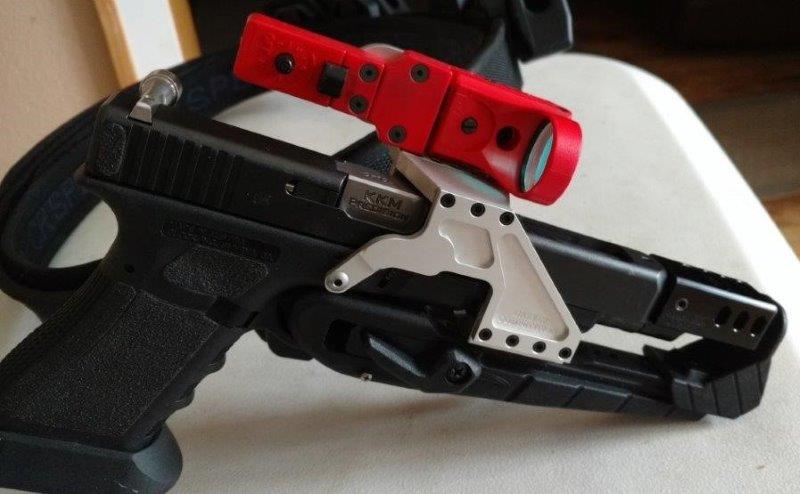

Postby usnret on Wed Jan 04, 2017 11:19 pm
Just go with a C-More. I have tried the FastFire's and didn't really like them for fast target acquisition. I find the dot and target much faster with a C-More. By the way, this is a Glock 34. The mount is from Carver Custom.
