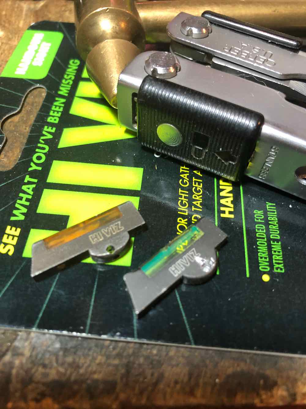

I'm working on replacing the front site on my S&W M325. I bought some numbered drill bits to drill the hole for the pin, but the sight is harder than I expected. I've gone through 6 bits and only got about half way through.
Does anyone know of a source for quality drill bits size #51?

If the Cobalt don't work (they should) you might talk to OldmanFCSA and pick his brain for an idea. When drilling with the cobalt, be sure to use a coolant, it will help prevent the bit from dulling as quickly.

Use a 1/16" carbide endmill in a rigid setup at a slower speed due to hardness of material. The remaining 0.0045" should just be able to easily be removed. . Be sure it is center cutting style.

You could hear up the part to take the temper out. Just saying :twisted:
