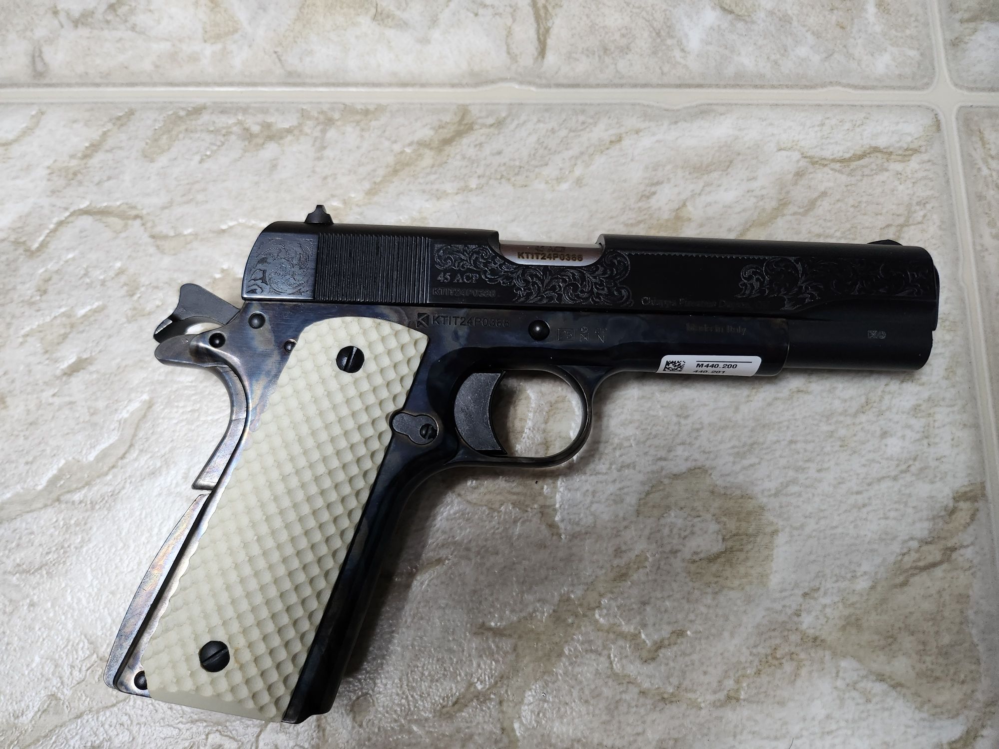

I purchased a 1911 from Palmetto State, Charles Daly GI spec 1911 for wild bunch.
I've owned several 1911s and this is the first one that drops the hammer when I take the safety off. This only happens when I pull the trigger before lowering the thumb safety.
I think this is due to thumb safety being out of spec or not fitted properly.
Anyone have a suggestion to fix this, I've sent multiple guns back to the manufacturers before and I would rather avoid that.
If anyone has a GI spec thumb safety that i could borrow or buy, let me know.

With safety on, push on the trigger. Then (in a quiet room) pull back on the hammer just a tad and listen for a “cling”. If you hear one, sear moved while safety was engaged and you need a new thumb safety.
Have you fit one before? Since this is a safety part and a 1911, I would make sure to start with a new part (Brownells, Midway, etc.) and fit that. New thumb safeties should not go into the gun without fitting.

gun_fan111v2 wrote:With safety on, push on the trigger. Then (in a quiet room) pull back on the hammer just a tad and listen for a “cling”. If you hear one, sear moved while safety was engaged and you need a new thumb safety.
It clicked.

Newer gun, bad safety… unless you did a trigger job on it this is on the manufacturer and should be a warranty claim item.
I wouldn’t buy a new safety. I’d get the gun fixed y the folks that let a problem out the door in the first place.

They are sending me a new stock thumb safety.

samginko wrote:They are sending me a new stock thumb safety.
Really . . .
I would think for liability reasons the would want it back to verify problem, make sure there isn't any other issues and replace the manual safety themself.
