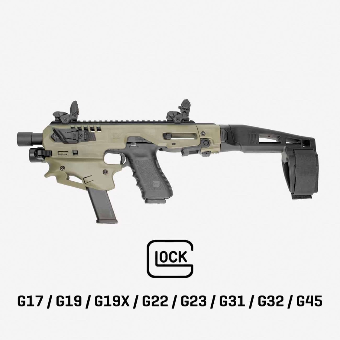

On the subject of G17s, what does everyone think of that CAA MCK micro conversion kit? Novelty, fun toy, or both?

Looks cool and expensive. :)
