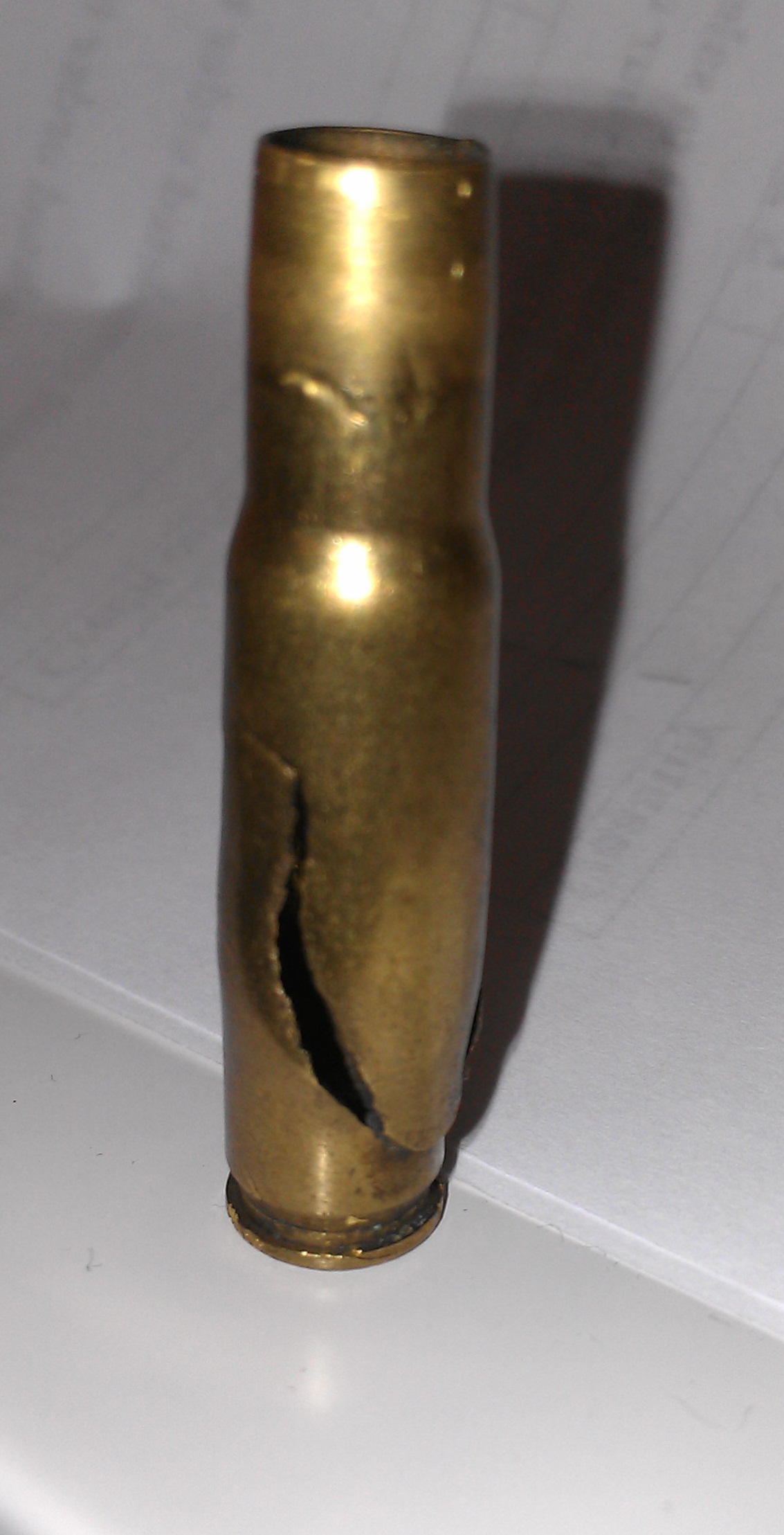

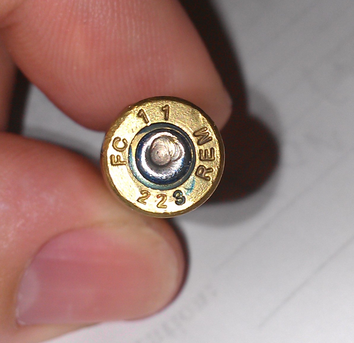

So, here's one from my collection on a Thursday morning. I found this at the range this past summer after watching it get made, the hard way.
See if you can tell whats been done? I know already, I just wanna see how good your powers of deduction are - and I wanna get my post count over 1000.

.223 fired in a .300 Blackout/Whisper?

There is a right way to fire form a case, and a wrong way. This looks like the wrong way... :shock:

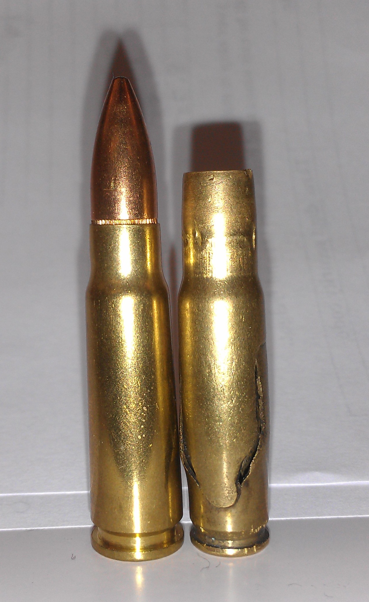

Alright, the fun has gone on long enough.
1) Not from a .300 Blackout/Whisper, look at the neck.
2) Not a bad case/round from any 2nd's room.
Here's a hint (next to a 7.62x39)
P.S. Happy 1000th post!

H&H wins -- AK's will "fire" anything. This round failed to cyle - other than blowing chunks of brass and hot gases over into the guy shooting next to him.
He'd been shooting his AR and had a couple of .223 rounds left on the table when he switched to his AK and started loading mags. He inserted 3 .223's into a 30rd mag, and figured out after this one exactly what he'd done.
I keep the brass as an example of making sure you're using the proper round for your gun....since accidents happen and all...

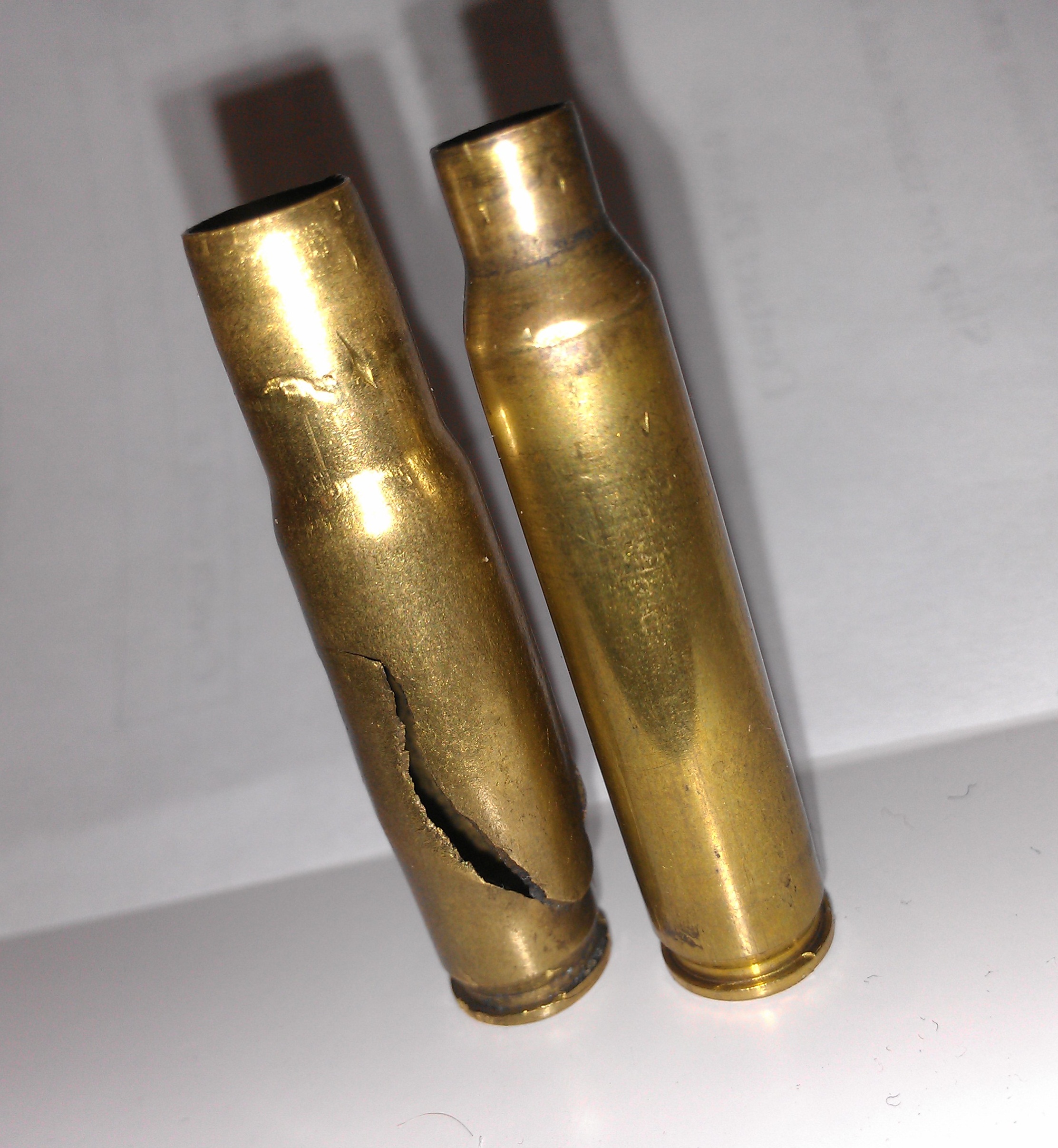

The pictures don't show it the greatest, but you can see where the brass case actually engaged the rifling in the barrel.
How this didn't result in more damage to the rifle/bystander/shooter is pure luck.
