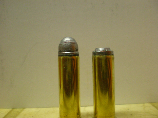

That said, to get an answer on yer crimp here, it'd be best if ya could post a close-up pic ... like this ...
IMO, that's a bit excessive ... not too much ... but a bit.
0.08in is quite a ways off. With light loads, in .38spl, I wouldn't think it'd be a problem. But my best guess is, yer crimping well past the crimp-groove ... probly over the top of the first band. :? That, or yer information's wrong.
On this bullet ...
... ya should be crimping so the case mouth bends inward jest behind the first band (roughly halfway along the length of the bullet).

I've attached a photo of two sample cartridges. In each one, I'm crimping on the first cannelure from the tip of the bullet--right in the middle of the lube-filled groove. The one on the right looks like it didn't go in squarely.

I've tried both the bench and the concrete floor "with a quick snapping wrist action" for "2 or three tries" so I'm suspecting an overly aggressive crimp.

I made several (more than 3) dummy rounds to get the crimp in the right place. Of course, I then couldn't pull the bullets afterwards. :(
