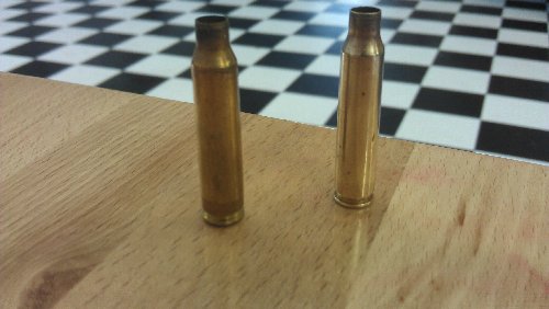

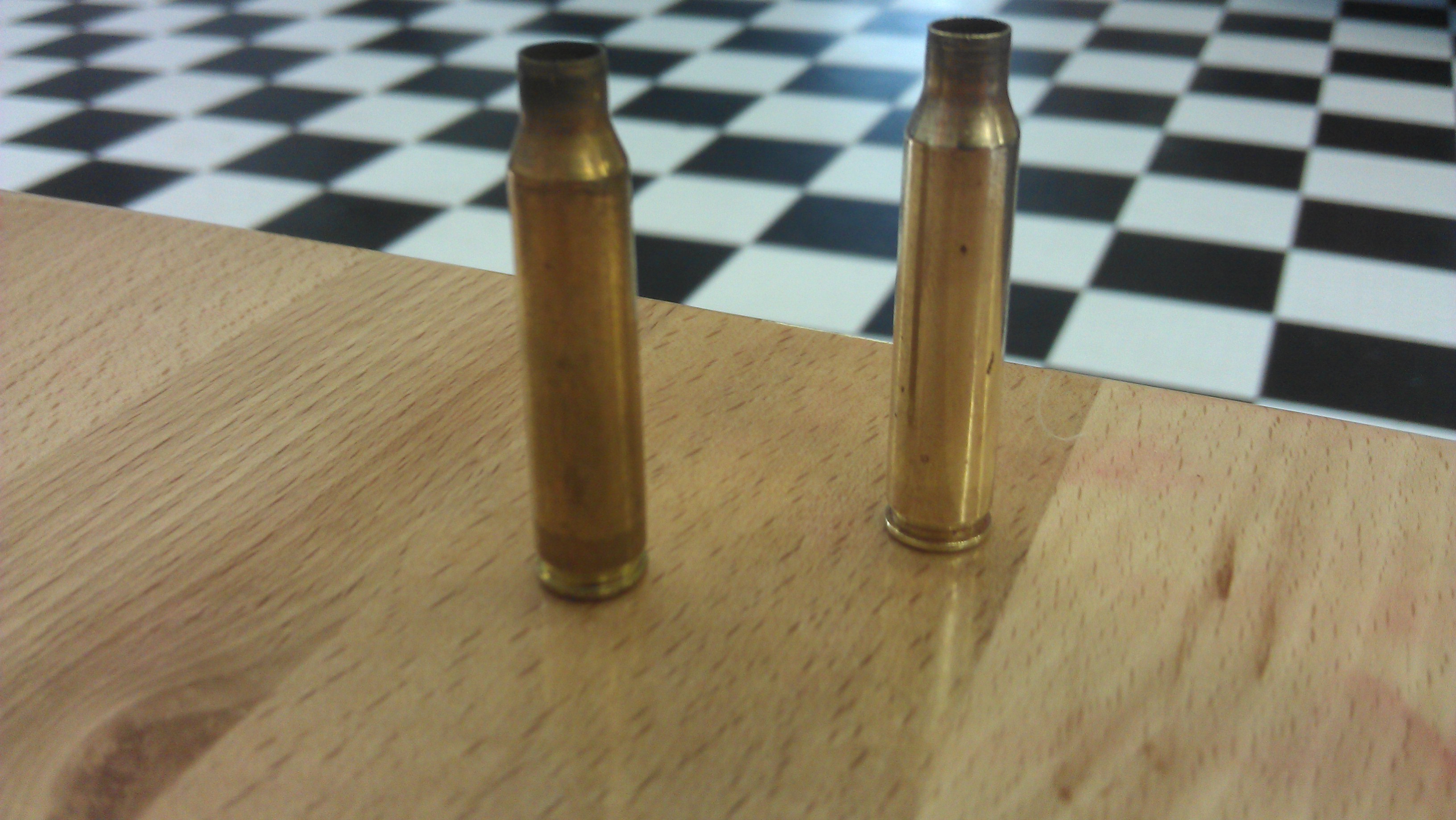

I found a rock tumbler from when I was a kid and I had big plans for this and that before I finally decided to just pick up some walnut media and start tumbling. After 4 hours this I what I came up with. It still seems a little tarnished and I was just wondering if I should keep it going, or if that is good enough and it won't hurt anything.
Left side is a case from the same lot that didn't make it into the first batch, right side is the tumbled case.
Thanks guys, I always appreciate the help.

Postby DoxaPar on Thu Jun 20, 2013 4:07 pm
I've usually run mine (Hornady tumbler) with walnut for 7ish hours.
I have no idea if I should, it's just how long it takes to clean up nicely.

I would not use a rock tumbler but a vibratory tumbler for you casings.

Postby LumberZach on Thu Jun 20, 2013 5:06 pm
Will it do any damage or anything? I plan on getting a vibratory tumbler soon, but I figured I would polish up some cases cheap with what I currently have.

Postby rtwills on Thu Jun 20, 2013 5:31 pm
I dont think it would hurt ( I have never tried it) but the vibratory ones will make the media work harder and probably be more gentle to the cases. I like corncob and usually put in in before bed and shut it down when I wake up

Postby JJ on Thu Jun 20, 2013 6:33 pm
If its a rock tumbler, I would assume that it seals? If so, SS pins would be a better solution than walnut.

Postby Vlad on Thu Jun 20, 2013 6:39 pm
A rock tumbler will work just fine, just takes longer than a vibritory tumbler. Use what you got... if this is a new experience keep your overhead low. Ss pins would work well but like the walnut would take a bit of time as well.

Postby MXGreg on Thu Jun 20, 2013 7:06 pm
I picked up a rock tumbler and some SS pins and did a test load with some weathered 9mm cases I had laying around, just to see how well it will work. The two cases on the right are what went into the tumbler, the two on the left are what came out after 4 hours. I will say, I'm impressed.

Re: First Tumbling
Postby Scratch on Thu Jun 20, 2013 8:25 pm
I have both vibratory and SS pins. If I didn't have anything, and cared about shiny cases, I'd go with the SS pins and a rotary wet tumbler. It is more time involved though with straining, rinsing, and drying. Don't worry about the pins causing a problem with the brass, the only reason people don't use SS pins exclusively, is the initial cost difference, and the extra work, but if you want über shiny brass, the pins are the shiznit. Plus you already have a rotary tumbler.
