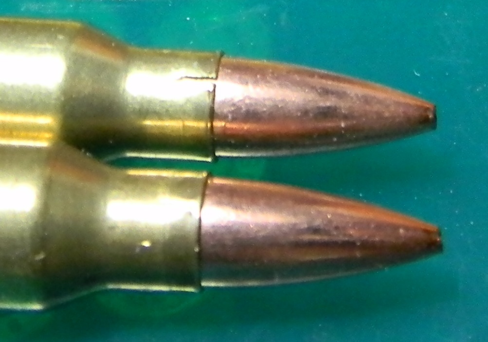

Postby Rodentman on Sat Nov 23, 2013 5:55 pm
I found these in a batch of fired brass I bought. Don't get too many rejects, but it's important to check. Wonder if these were 1x fired. No matter, when they're bad, they're trashed.

Postby Rip Van Winkle on Sat Nov 23, 2013 6:16 pm
What brand of brass? I bought some WCC06 last fall from Wideners that I'm finding cracks in the necks on the second loading.

Re: Check your brass...
Postby FJ540 on Sat Nov 23, 2013 6:34 pm
I'll take 'em if you bring them to a gathering sometime. Works for cutting down to 300blk. ;)
Postby Rodentman on Sat Nov 23, 2013 6:39 pm
FJ540 wrote:I'll take 'em if you bring them to a gathering sometime. Works for cutting down to 300blk. ;)
OK I'll save all the .223 brass with bad necks. So far just a few.

Postby OldmanFCSA on Sun Nov 24, 2013 1:16 pm
Any brass from an unknown source should be annealed.
With blowouts in the neck-shoulder area, chamber needs a good cleaning and a check for damage.
