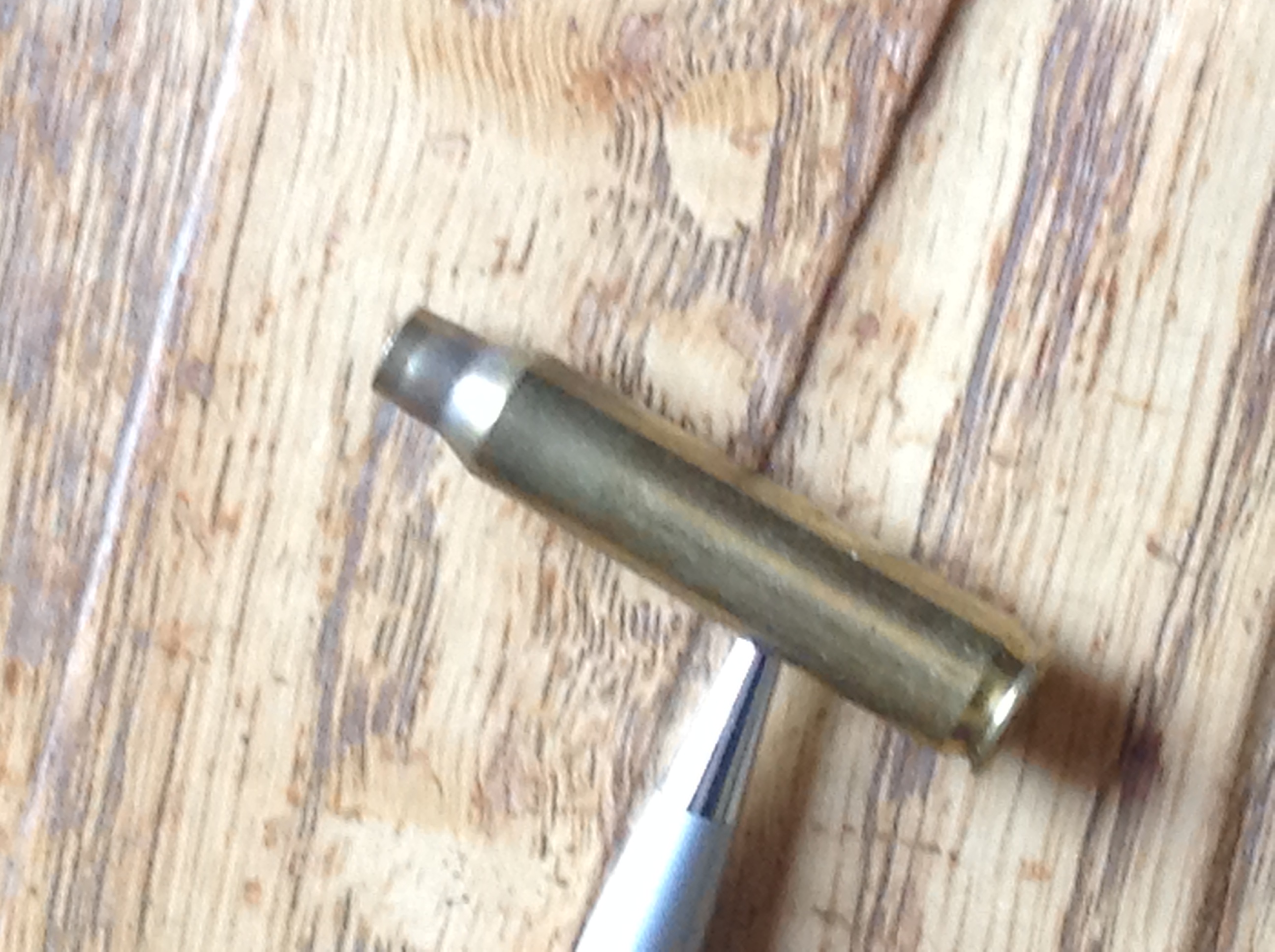

So I went to deprime some rounds last night and after 9-10, one jammed in the decapping/sizing die. So I drilled and tapped and screwed it out. I went back and with a tiny tiny bit of PB Blaster on the round tried the press again. No go. It froze about 3/16" before 'seating' and the primer never budged. So I tried another round....same thing. (These are LC empties) So I tried IMI empties. Same thing. Look at the pic- is the die now shot for some reason? It seems like it wants to make it a .17!
I tried applying more presssure thinking I'm just being a puss, but the whole backside of the bench started lifting. What the heck? (The die is stamped 223 Rem) Thoughts?

Thanks XdED, I've read about the dreaded excess lube, and have seen casings damaged as a result. They usually look like dents on the shoulder, whereas this is crunching the case mouth (is that a case term?) in the pic, see how it really wants to cinch in the neck right at the opening? And I did run a couple rounds in without any lube, thinking the little that was in the die from a prior round was plenty sufficient to cease sticking.

It's hard to tell from the photo, but is the neck being pushed into the body by the expander?
An unlubed case neck or expander might do that
When I mentioned lube, I was thinking it might be too little. Too muck might well wreck the case, but I don't think it would cause a jamb, or hydraulic lock.
Possibly the wrong diameter expander...

go back and look at the first case you stuck, is the entire case mouth/neck intact? or did part of it rip off and stay in the die?

Ok, so I took out the die and made sure there was no brass in it. A paper clip runs smooth all the way around the interior with the exception of one tiny spot- it sticks there (?) Then I made sure the air hole is clear- it was. So I screwed it back into the press and tried it all again- took a lot of force, but it finally punched out a primer....but more interesting was the fact that the case came out drenched in oil. Huh? And of course the shoulder was dented. So I ran another dry and it too came out wet and dented. Then another and finally on the fourth it ran fine. Then I ran six or so rounds with no lube until it started feeling tight. A little Ballistol on the finger tip rubbed on a case and again dented the shoulder! It seems like there a really fine line between too much and not enough.

Did you clean the die before using it?
Pretty heavy duty preservatives on them when they ship them.
Use a spray on lube or imperial. You don’t need much, but if you stick one in, it can be a major undertaking to get it out, even with a stuck case remover.

Agree you need better lube. Clean out the die, and get some Imperial sizing wax, my favorite. That little tin will last a loooooooong time.
You shouldn't have to grit your teeth to push a case into the die.
