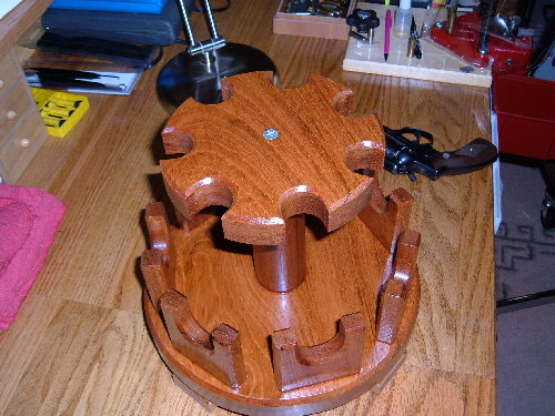

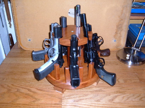

Postby floydster on Wed Oct 10, 2012 9:32 am
Pistol rack I made.
Pistol rack I made.

Postby sawgrass on Wed Oct 10, 2012 9:48 am
Thanks for the ideas so far.
mbree if it isn't too much trouble, could you post a pic of the completed rack? Thanks.
Oldman I have to look up Delrin dowel. I don't know what that is.
ETA: Floydster you just took spin the bottle to a whole new level! :D

Postby SparkyJeff on Wed Oct 10, 2012 9:53 am
floydster wrote:Pistol rack I made.
Cool!
Reminds me of grandmas spice rack.
