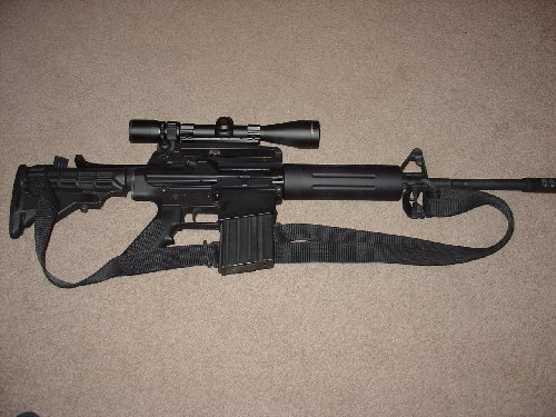

Postby jp8775 on Wed Mar 21, 2012 1:31 pm
Got the gun back from DPMS, the whole lower back of the cartridge is gone. The case is still in the chamber. They just said it was a catastrophic failure. 1/4 of the case (head) is gone. The case (neck and barrel) is still in the chamber. I will try to get a picture of it, but just may not be able to. If someone who can do this I will meet with them. DPMS made this like new.

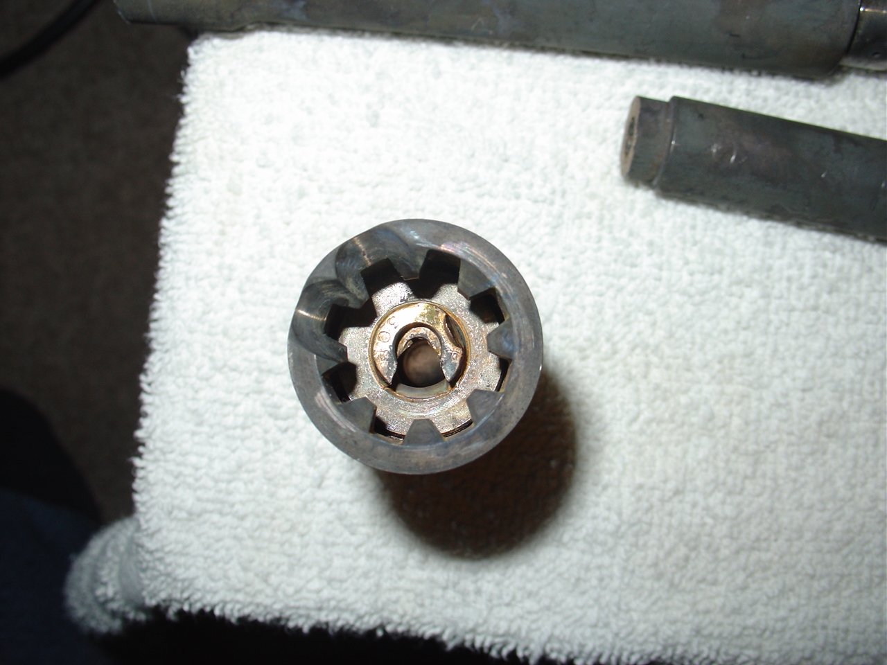

Postby jp8775 on Wed Mar 21, 2012 5:26 pm
Here is the case still in the chamber.

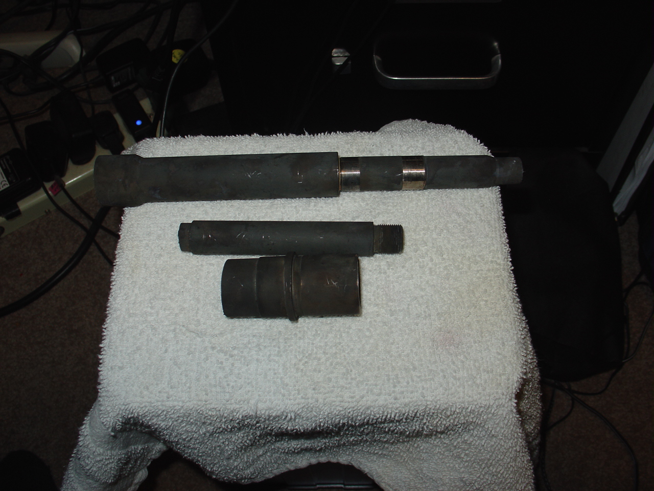

Postby jp8775 on Wed Mar 21, 2012 5:28 pm
Here is what they did to the barrel

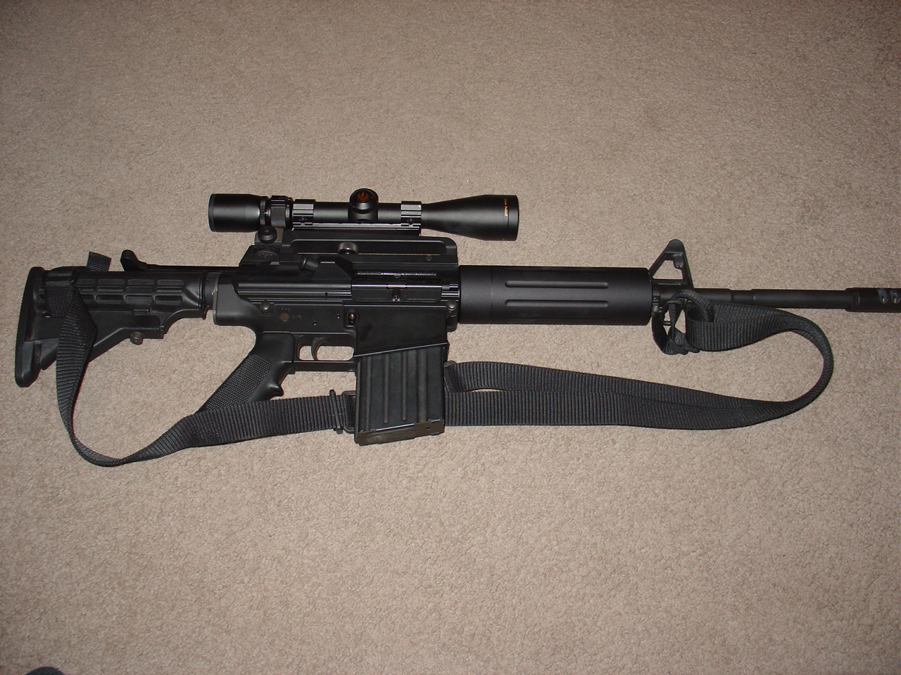

Postby jp8775 on Wed Mar 21, 2012 5:29 pm
Here is the gun back together.

Postby OldmanFCSA on Thu Mar 22, 2012 10:05 pm
Did you by chance have a failed case on previous shot that left part of casing in chamber.
Next round would have had extreme pressure because of partial chamber/barrel blockage.
I've heard of this happening once before, did you have to use forward assist to chamber last round?
Either way, it sucks! Just glad you are not wearing part of that rifle in your face and hands.
When a 50BMG comes apart - EVERYONE knows about it!
Possibly you had a powder charge bridge in charging tube, not dropping full charge on previous round, then dropping new charge and whatever remained of bridged powder into next casing. I've had this happeen to me several times, which is why I hold loading tray with charged cases under bright light to enable visual comparison of powder height in casing before seating bullets.
Just trying to think WHY ???
