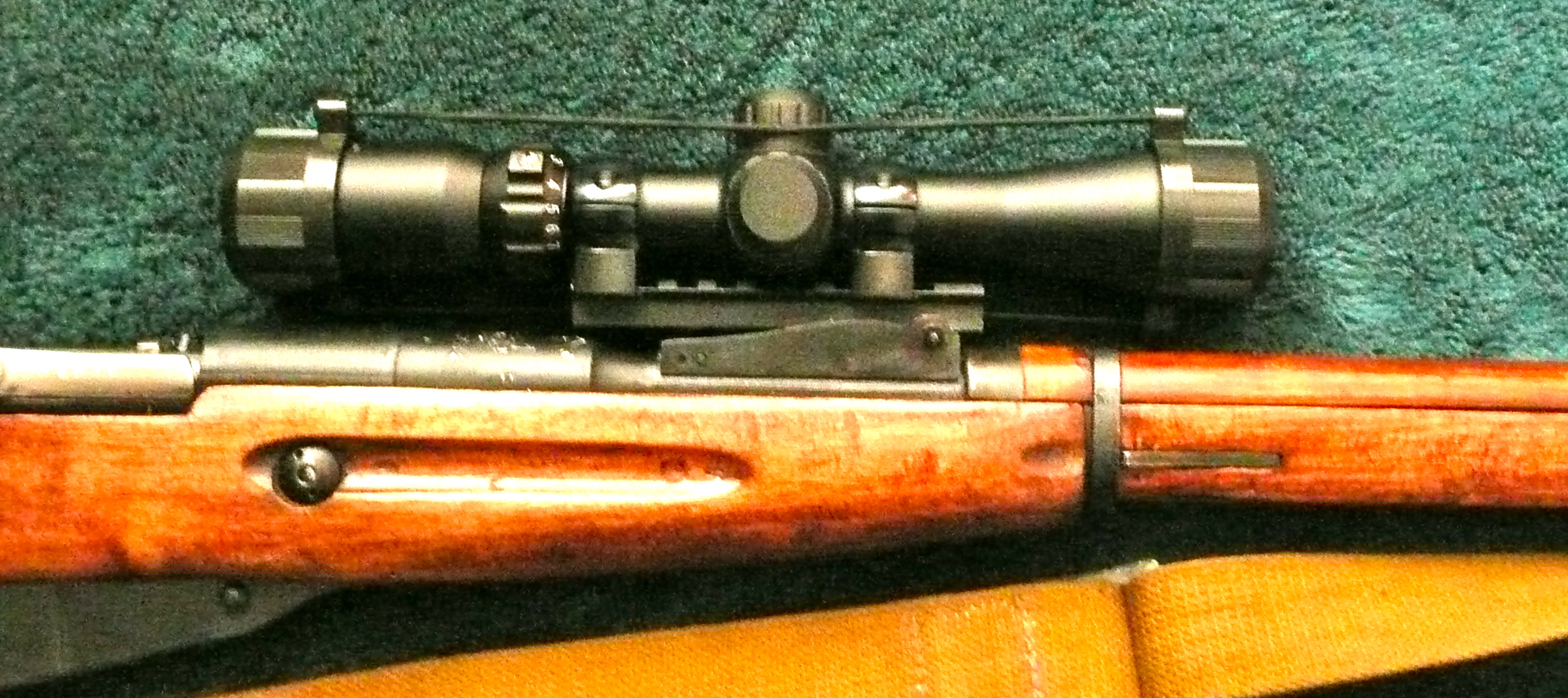

So tonight I went and got the UTG tri-rail set up that goes to the rear sight. I thought I would be able to mount a scope far enough back to view it easy.... :hmm: Not so much. However the mount its self seems decent enough and should hold well. I only had to use Ye old attitude adjuster once
. My options are scrap this mount and go different, or just find a long eye relief scope. If anyone has suggestions on this type of scope let me know.

I had a scope on my MN. I used one of those mounts that relpaced the rear sight. It was OK, but you needed a scope with a long eye releif. The bonus was you didn't need a bent bolt. I took it and the ATI stock off because I went back to the original wood stock look with iron sights.

As far as scopes, the original or replica Kochetov side mount requires a fair amount of skill to attach correctly. Scout mounts are way easier.
Darrel's scout mounts are excellent: http://parallaxscurioandrelicfirearmsfo ... forums/116
Mounts to avoid:
The really cheap aluminum Chinese mounts from eBay. The screws are thin and weak and they don't hold zero well. It's only $10, but it's a complete waste.
The AK-style rails. The adaptation to the Mosin receiver is cludgy, the scope mounts that fit them are almost always too tall and often made of crappy metal.
The ATI mount. The mount itself can be attached somewhat reliably, provided you are very careful with it afterwards. It's fairly easy to bend or break off if you drop the rifle. The bolt handle they sell with it is junk. It's been known to snap off.

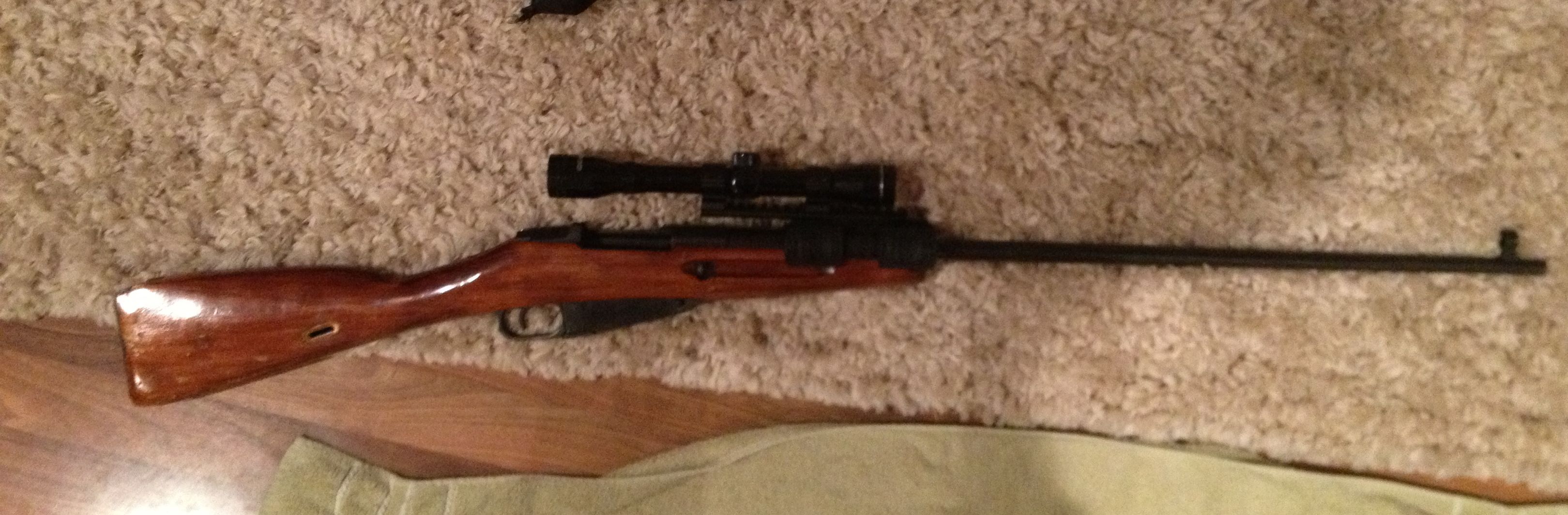

It was in line with the top of the barrel, where a normal scope goes, just right where the rear sight is. I got mine used but this is kind of what it looked like.

Heres my Izzy with a scout mont and a BSA 2x7

ETA, Mounting a scope to the rear sight makes for a really really long eye relief. Thats why I chose the method in the link.
