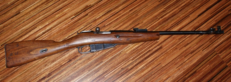

Meet Bubba.

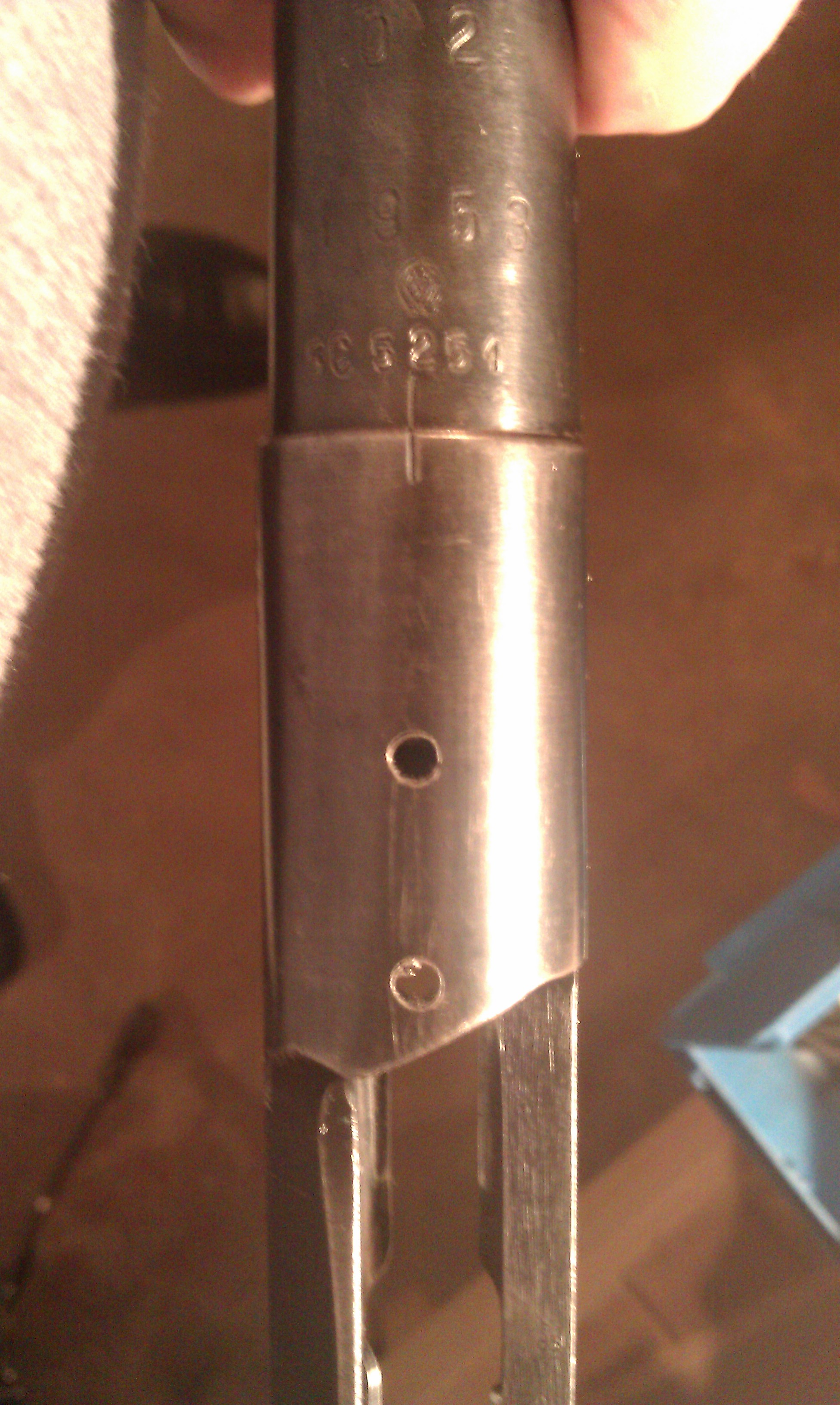

Bubba is a 1953 hungarian M44 with some issues. This is the condition I purchased this in, here on the board. I read about people "sporterizing" (read: butchering) these rifle, and figured that since this one was already tortured, that it would be a fun project.

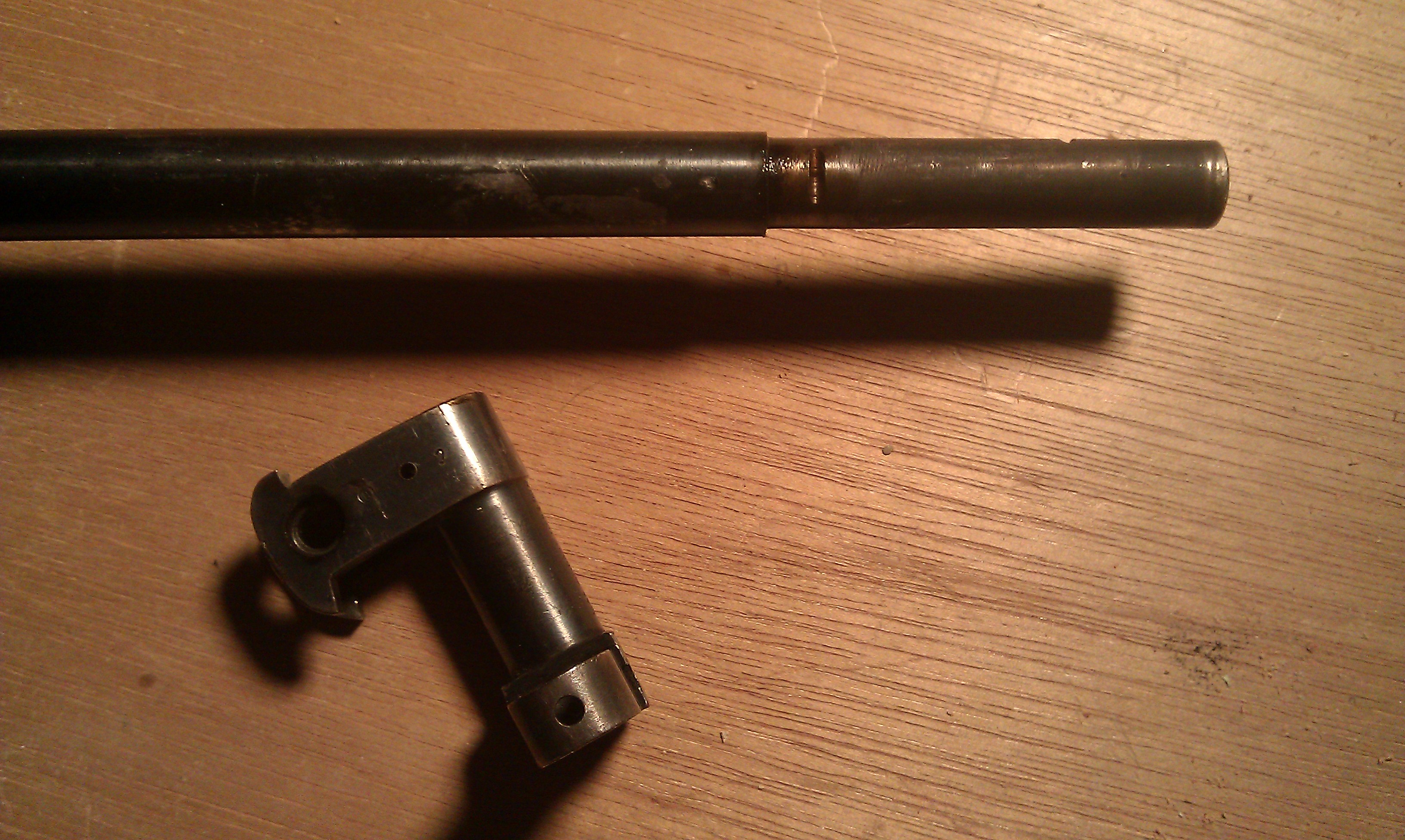

Step one... remove front sight assembly.
This is more difficult than it appears. There are two pins, and some sort of demonic bonding agent and about 4 gallons of packed in cosmoline holding it in place. Needless to say, after a few beers, a lot of **** talking, and seemingly endless opunding with a 16oz claw hammer, it came free.

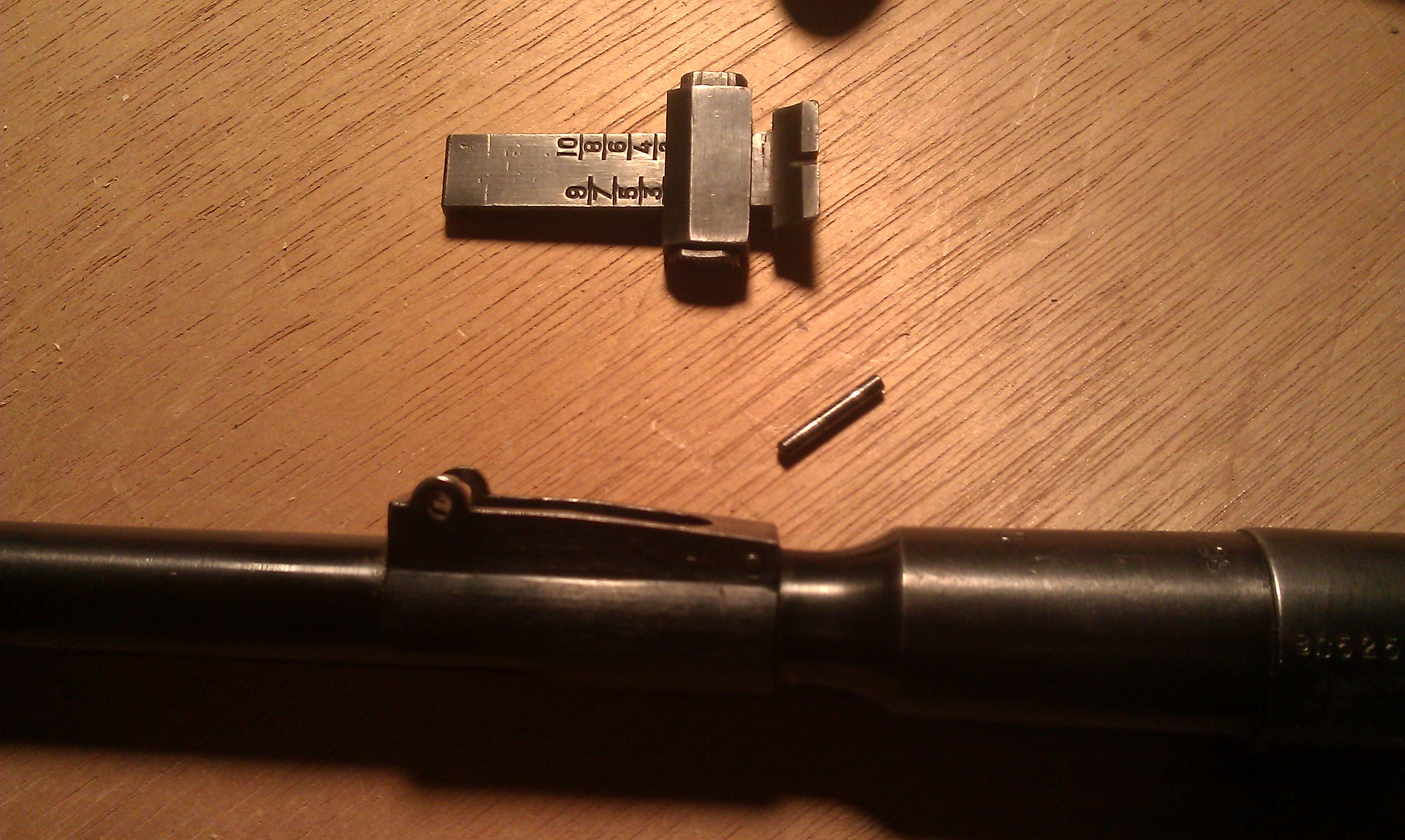

Next was to remove the rear sight. This wasn't necessary, but since we were beating on a rifle, I figured... why stop now?
One pin, and it slid right out.

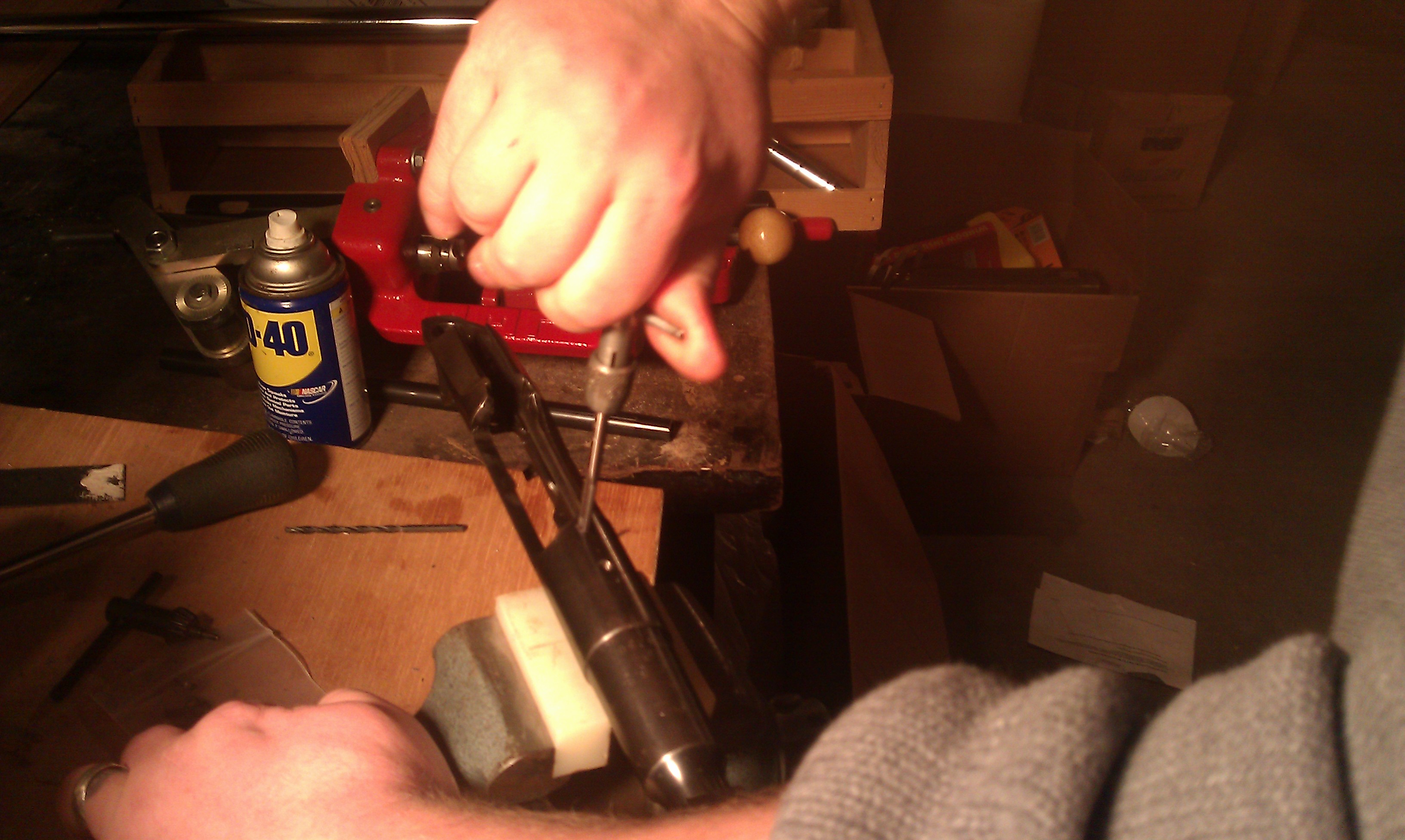

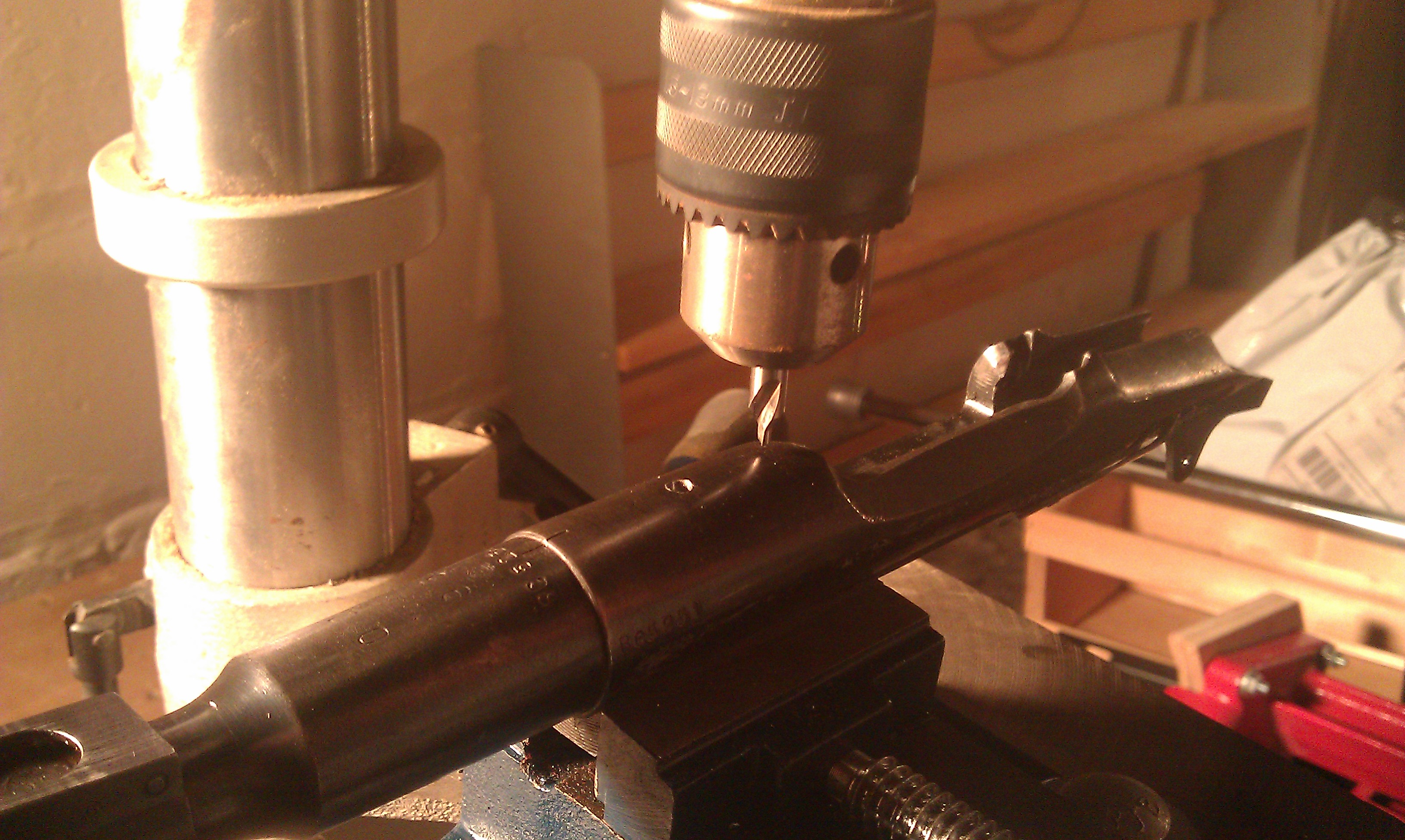

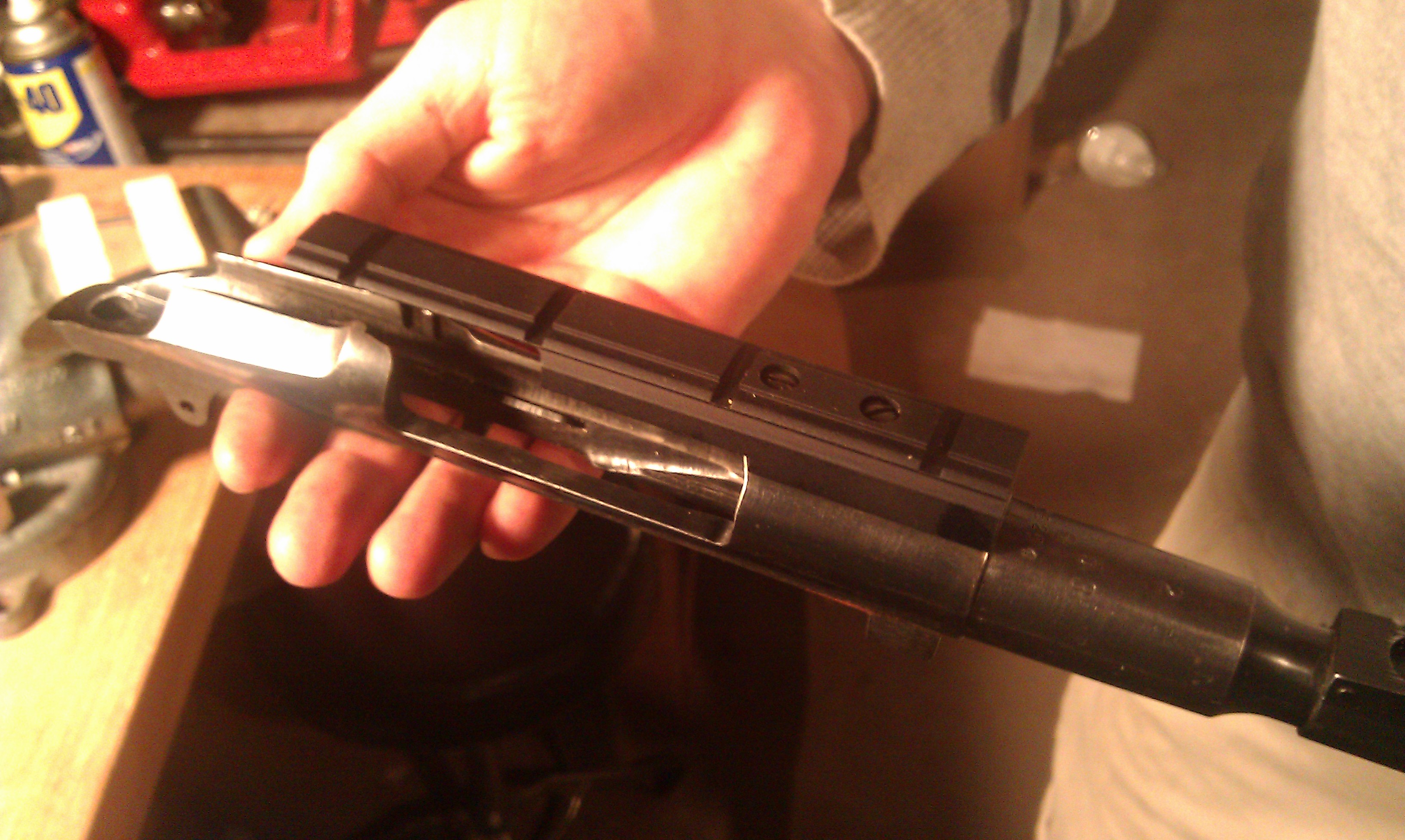

Here is the sequence of marking, drilling and tapping for the scope mount.
This all went pretty well with the help of Shipyard, his basement and his beer. The steel in the receiver of this rifle was surprisingly soft, but after getting the mount attached I was amazed at how stable it is. No movement at all.

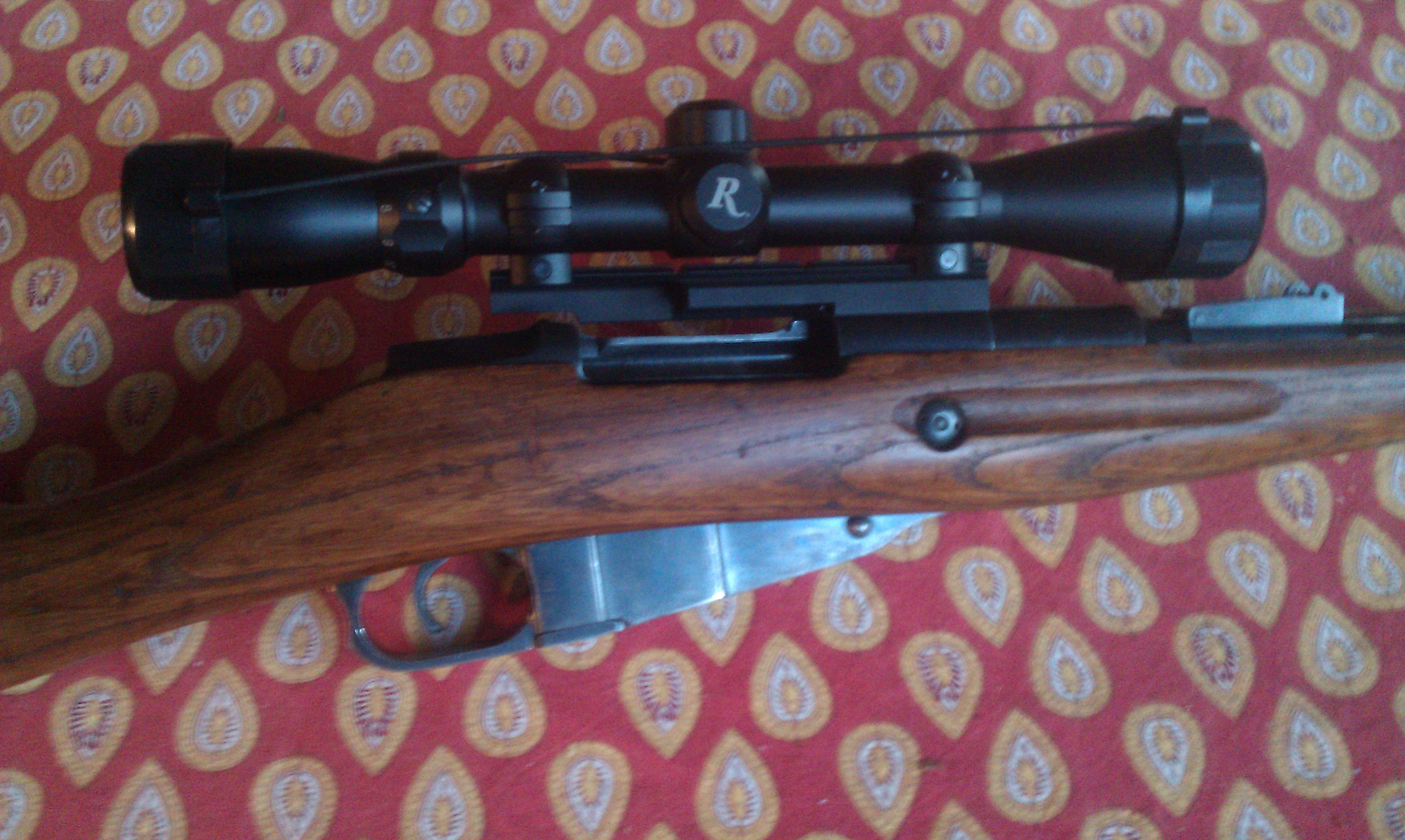

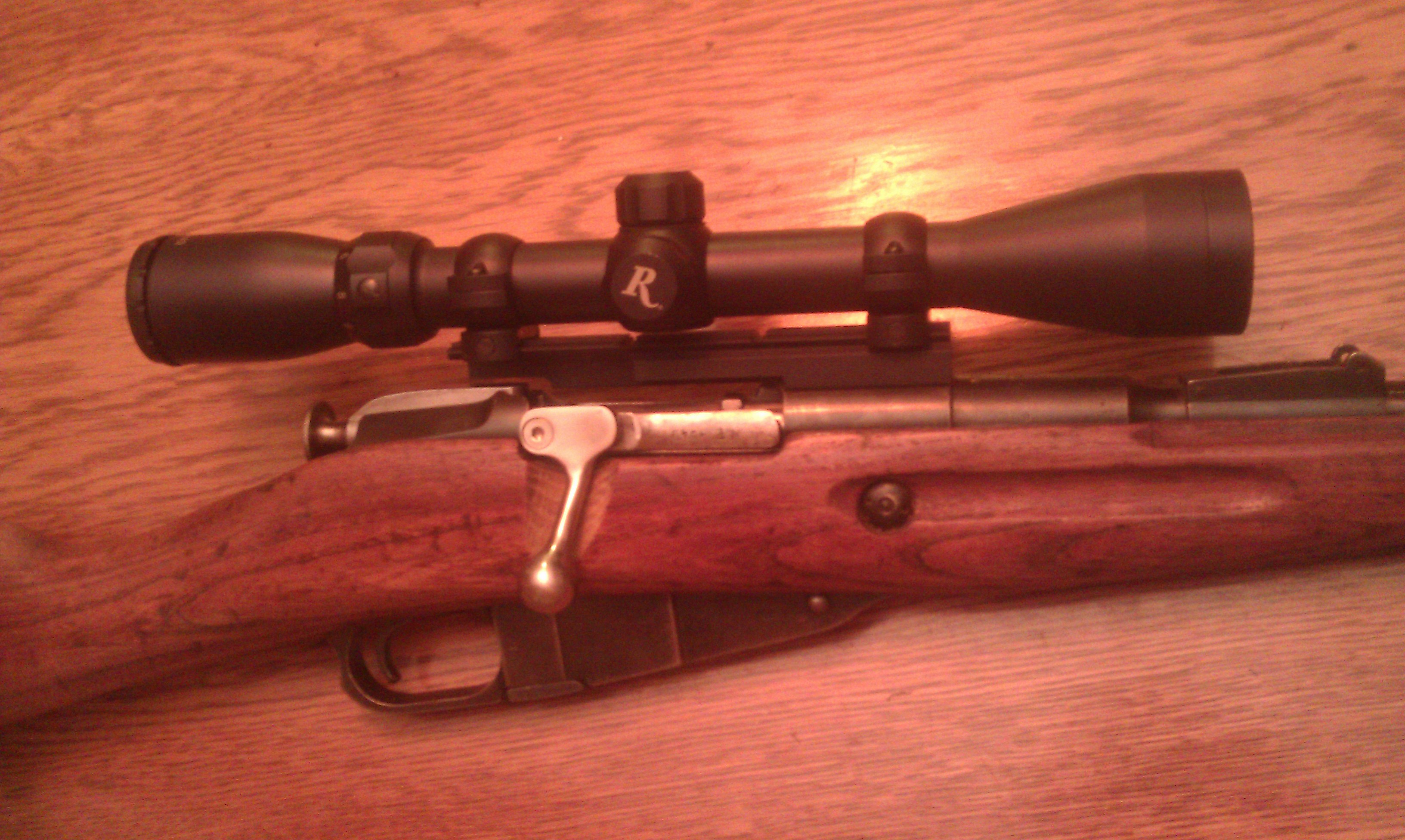

Here is with the scope mounted.
All in all it looks OK, and works a lot beter than expected!

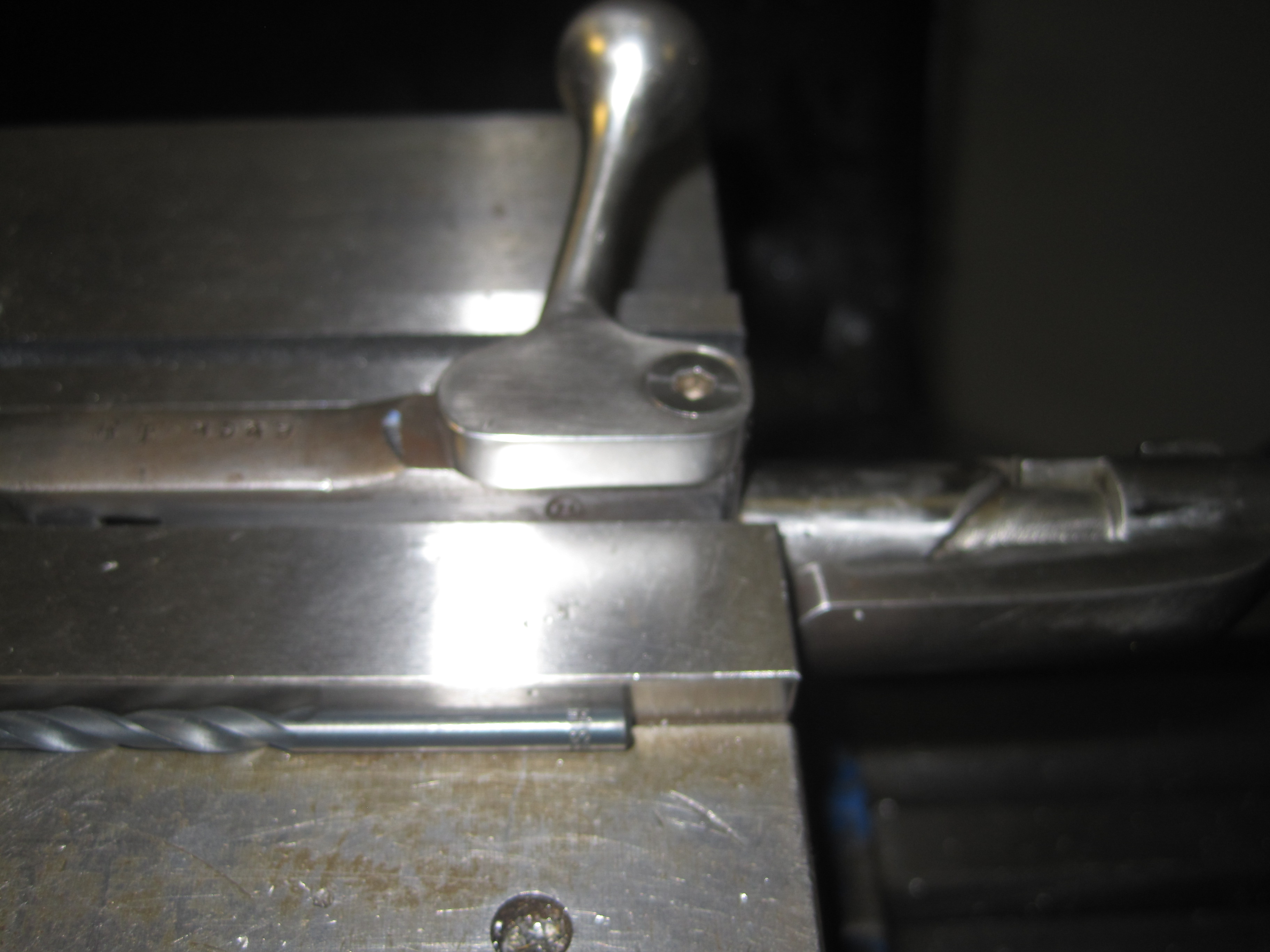

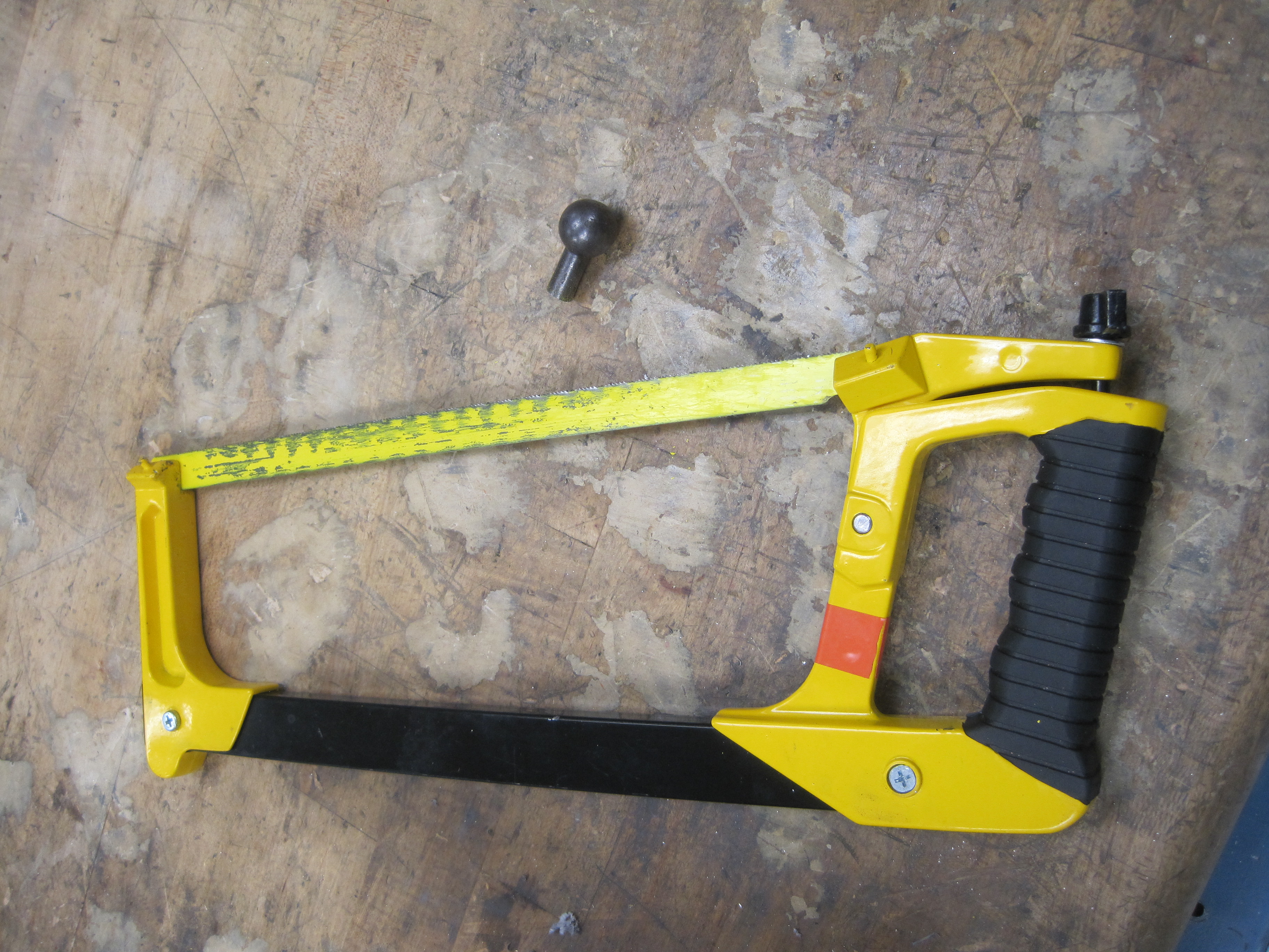

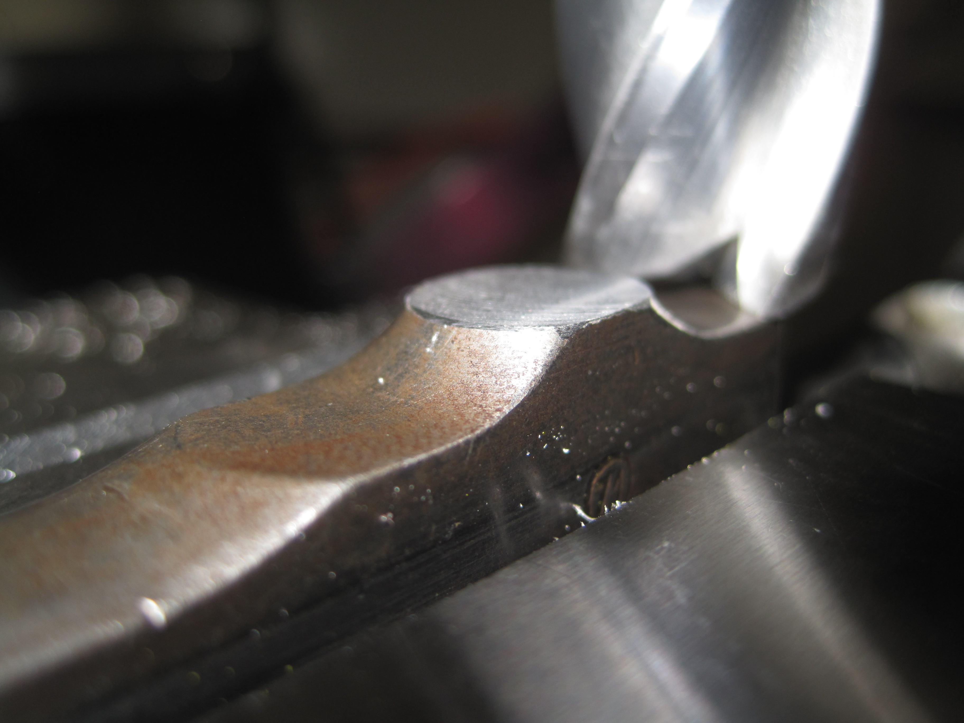

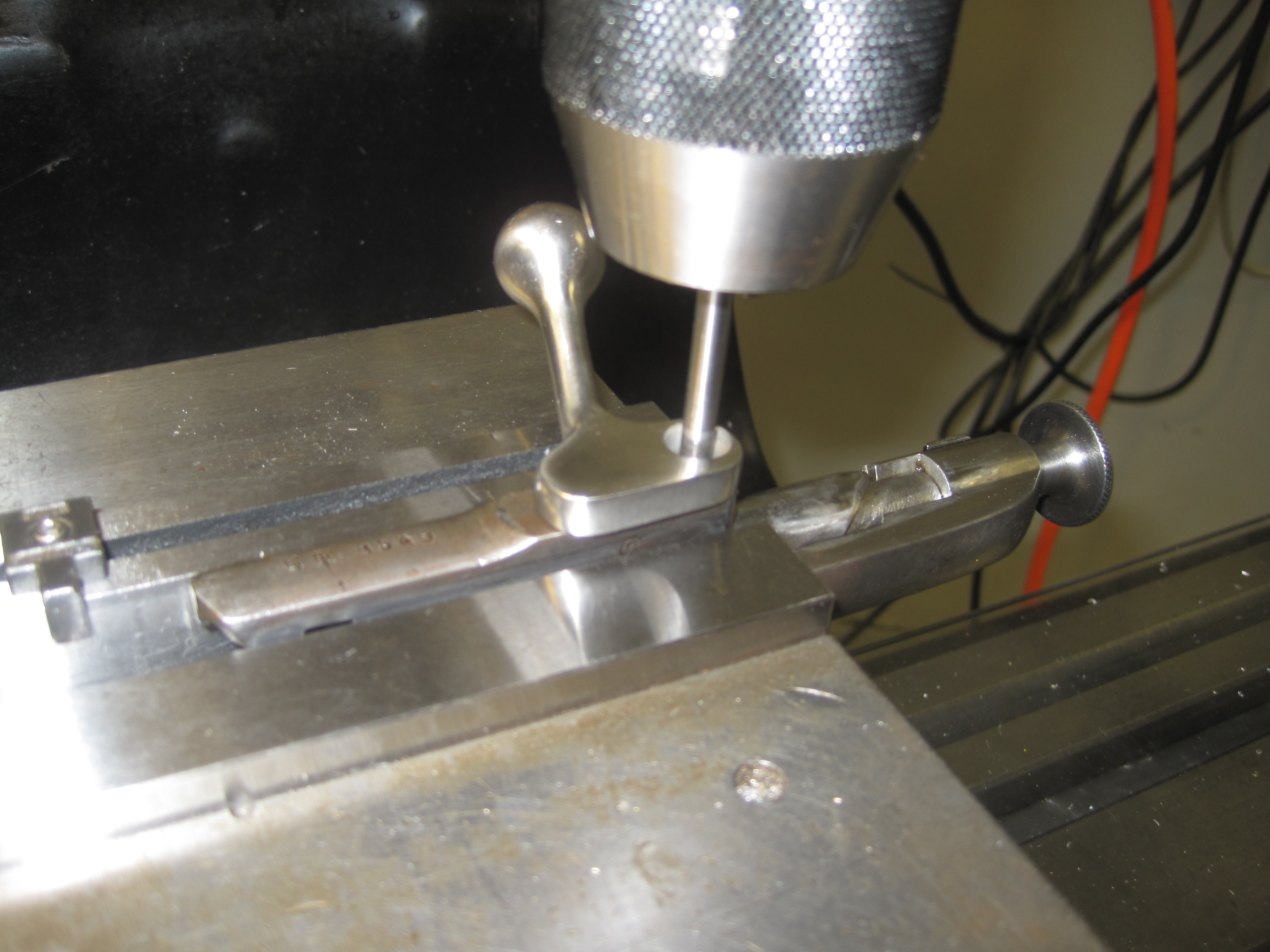

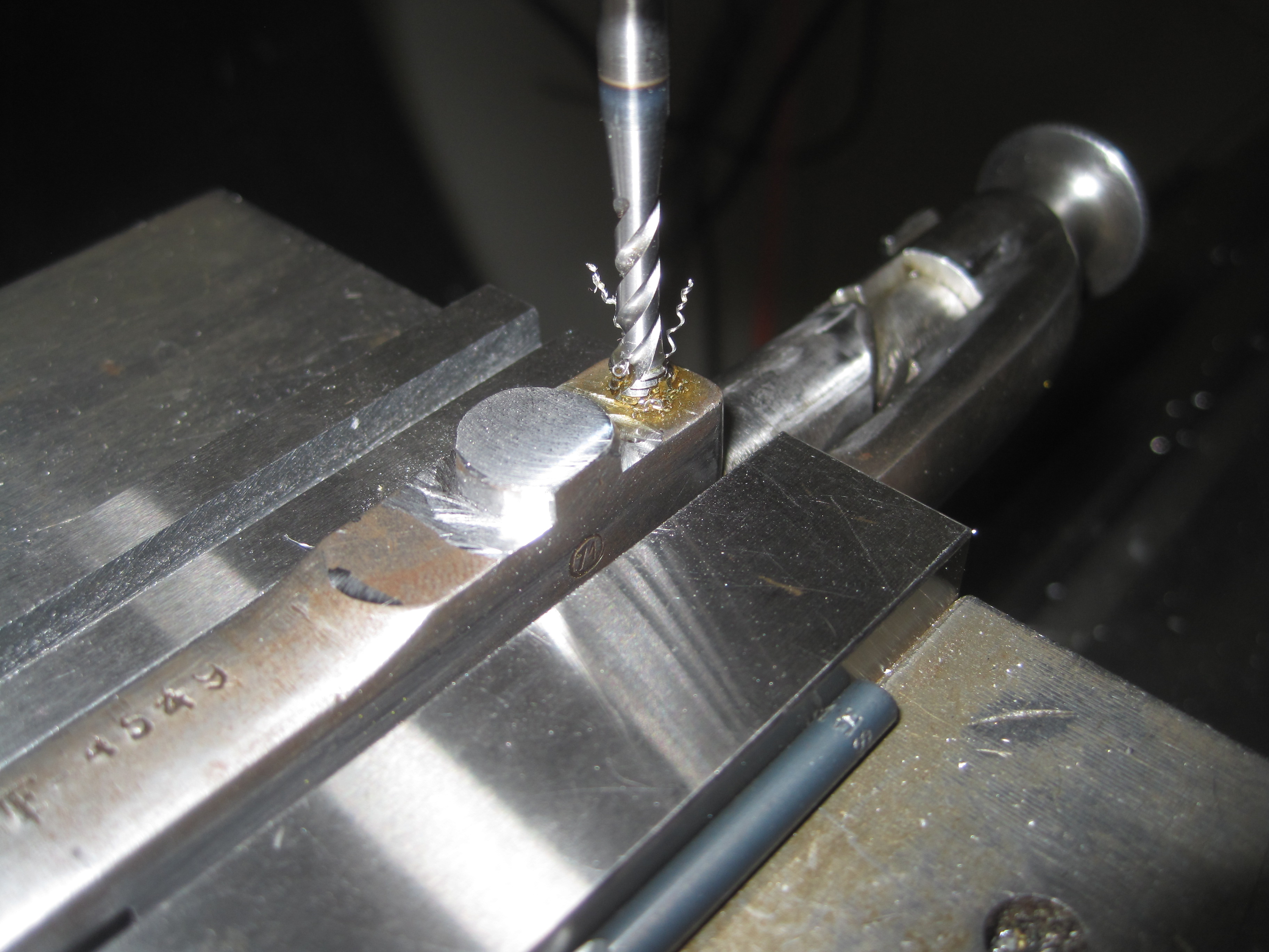

the bubba bolt handle:
first - trusty hacksaw. oh yeah, hacksaw.
second, fixture up in the mill. use gauge pins to center as good as you're going to get and lock 'er down.
mill the rough cut flat. measure the inside of the bolt handle cavity and mill it down to the same diameter, about 0.005" at a pass. it's REALLY soft "stainless" - man, i love cold war "steel" :D
once it's at the right diameter, carefully cut flat the chamfer around the post. it's a radius up into the bolt handle and you're going to need to get rid of it for the new handle to fit flush against the bolt. take some time - after all, you're on the clock :?
once the new handle fits down nice and flat, get it nice and straight and center up for drillin and tappin the screw hole. i used a gauge pin the same dia as the clearance hole to center up where i wanted the handle to lie. are there better ways? yeah - a ton. it's a bubba job. i'm goin easy today :P
centered up, clearance hole drilled down about 0.300". use the mill to power tap starter threads with a bottom tap. finish the hole off by hand. i'm lazy today and i sure as hell don't feel like bustin a tap in dat ass (see what i did there???)
since the "post" of the old handle is cut down good to a really good mate to the handle, the one screw design is actually REALLY solid. i was completely prepared to put antoher screw in about 0.600 center to center with the one that's allready cut to be there but i really didn't think it would be needed. the inside mating surfaces are allready nice and roughed up so spreaddin up a later of JB weld/JB kwik behind it and screwing it down should be 100% sufficient if the single screw starts to loosen up with/without some threadlock.
all in all, took me about 45 minutes and i was jerkin the clock on the big fun time machines. had a good day.
