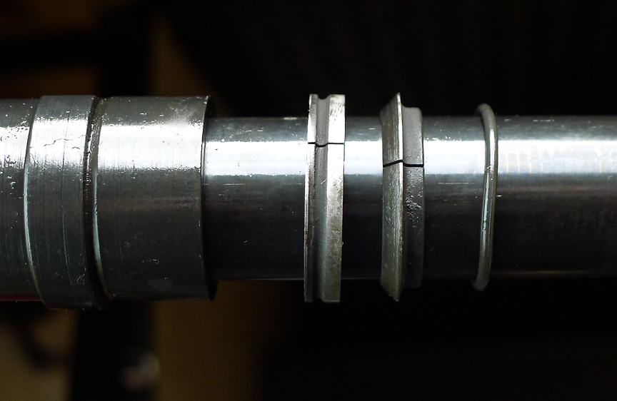

Postby centermass40 on Tue May 27, 2014 7:45 pm
Your gas rings should look like this when assembled. Make sure gas ports in barrel are clean.
