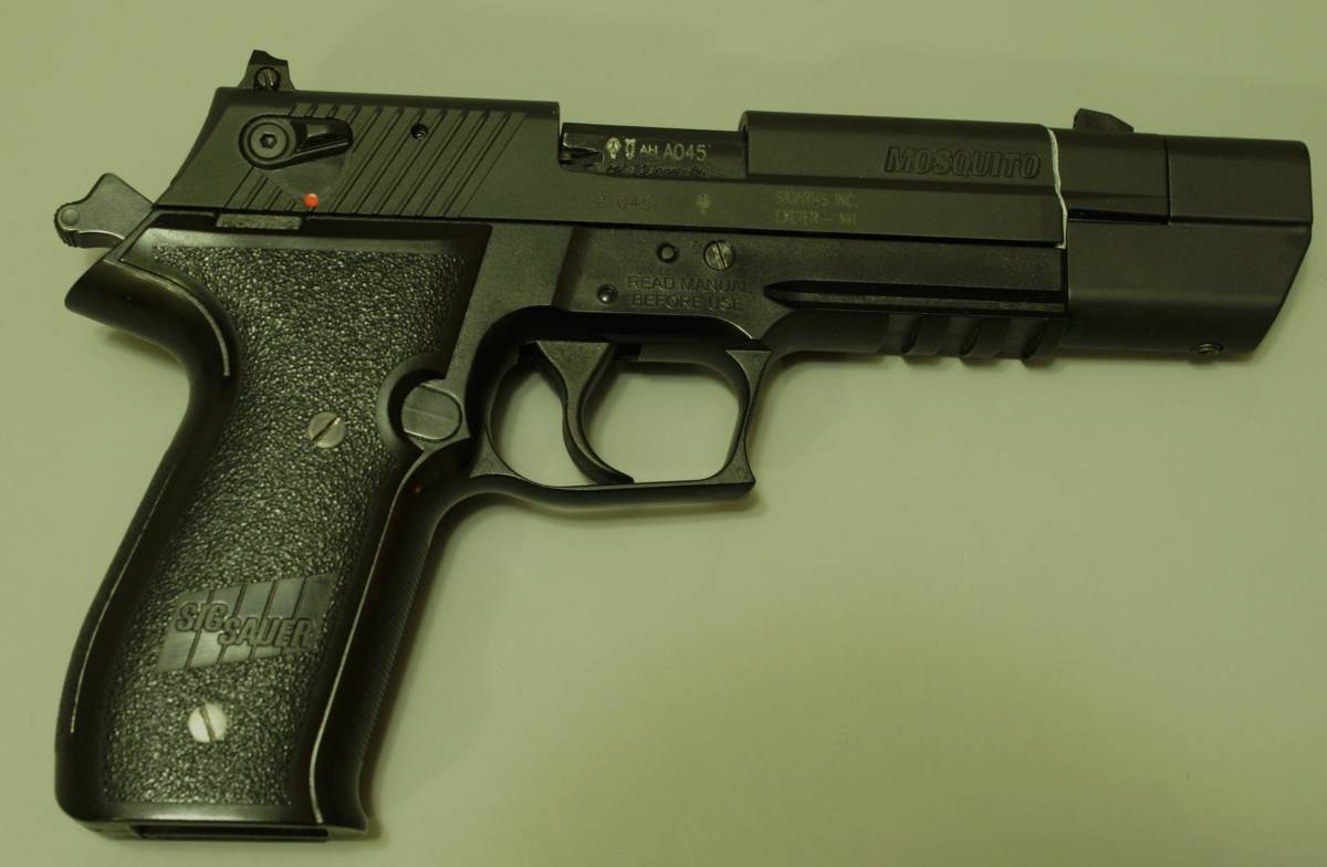

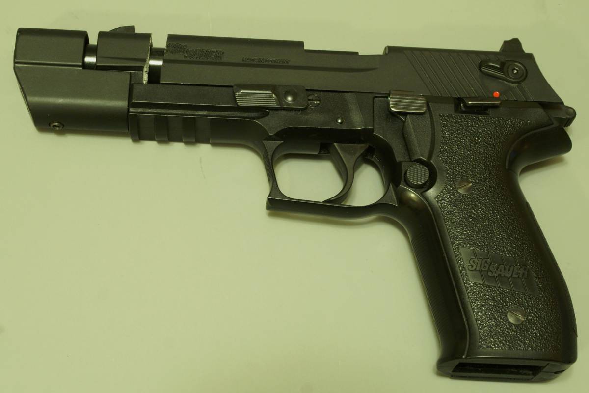

I was almost done at the range...firing a few more mags through my Mosquito and the slide locked open, which was weird because the way I was gripping the gun I was holding the slide release down... I was like how did the slide come off the frame??? I bought it in 07 or 08 and its got thousands of rounds through it, but come on, what kind of crappy metal is this?

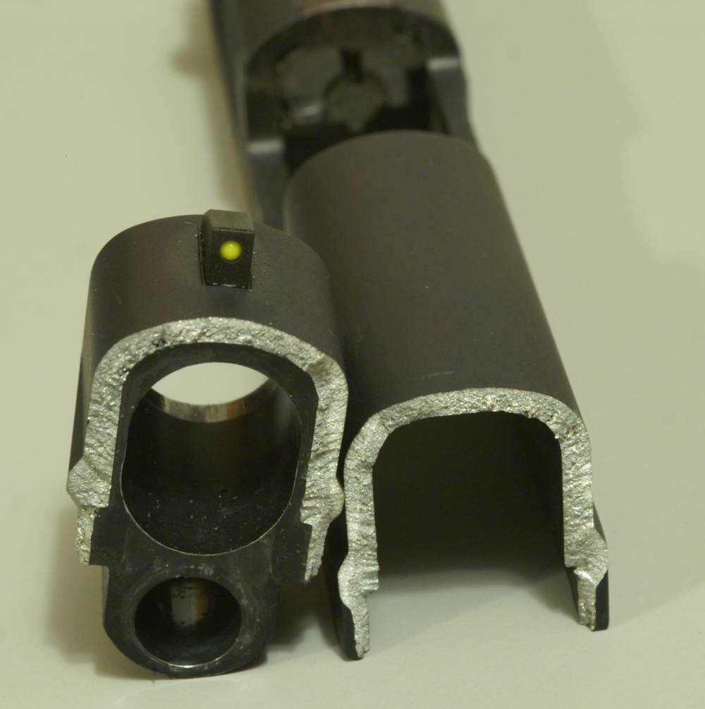

I see three stages of material failure, you should have caught it after the first two!

OldmanFCSA wrote:I see three stages of material failure, you should have caught it after the first two!
Can you explain for those of us who just see "broken".
mrp
Posts: 960 [View]
Re: The Slide on my Sig Mosquito failed catastrophically today..
Postby OldmanFCSA on Thu Dec 22, 2011 1:02 am
Stage 1 = Picture 1
Stage 2 = Picture 2
Stage 3 = Picture 3
OK - Ignore the above answer - ignore the first 2 pictures - Then
Stage 1 - the slide casting has sharp corners cast where 2 masses of metal meet causing an area where strees cracks are likely to form = bad design & manufacture
Stage 2 - use "Ctrl" and "+" keys to blow up Picture 3 focusing on molecular structure of exposed casting - See the line??? Due to bad Engineering in Stage 1, the slide cracked thru almost completely during a previous shooting period. The surface of cracked material seems slightly muted due to hammering of faces that occurred between cracking and breaking.
Stage 3 - See the last little bit of material that broke causing visible failure and 2 pcs.
LOOK CAREFULLY - you will see failure areas - then look for "root cause analysis" = Stage 1 stress areas.
Postby OldmanFCSA on Thu Dec 22, 2011 1:05 am
I'm not a SIG fan, but my Berrettas have also had failure issues, after 50,000 rounds on same slide, on a pre-production test model.
VERY GOOD PICTURES - they show the cause of failure clearly - SIG should not have an issue with this failure.

It should be pointed out that this is a special Sport model of the Mosquito. The standard versions do not have the extension on the front where this one failed.
