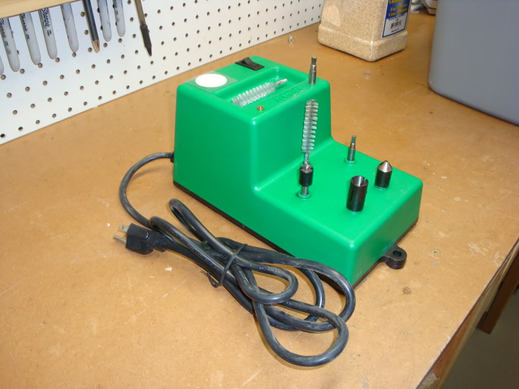

I use an RCBS case prep machine to hurry the process just a bit. Does the deburring inside and out, primer pockets and a final brush to make sure all the media is out of the cases. They run about a hundred bucks when they are on sale.

I have one of the RCBS case-masters (I think that’s what it’s called) and it’s way too slow for bulk brass processing. It works okay if you’re doing small lots though.
