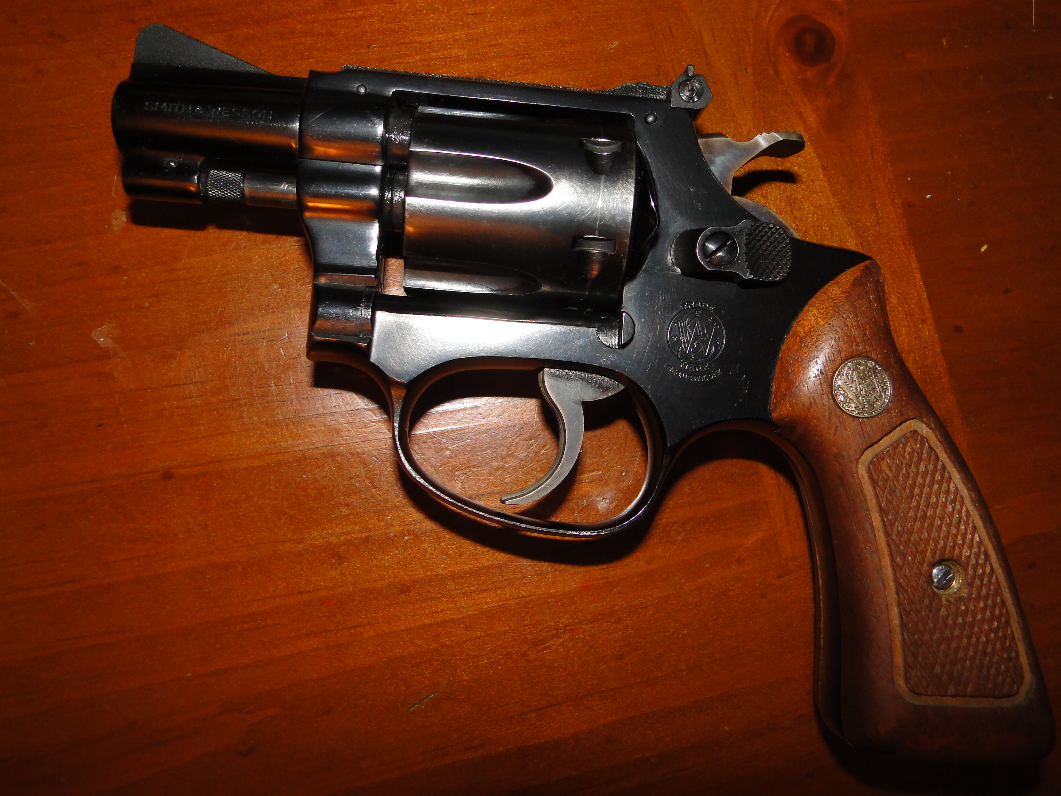

Postby VikesFan1 on Mon Feb 10, 2014 11:04 pm
Picked up Saturday from Alhman's and went straight to BPR. The cylinder fits now but they didn't tell me what the problem was, or how they fixed it... but whatever, now it doesn't extract spent cases without tapping profusely on the extractor rod with sharp, blunt blows.... I gave it a good cleaning tonight and will go back to the range Friday. Valentine's date with my wife. She's never been to the range... and this is what she's supposed to shoot, despite not extracting because somebody couldn't check their work

Postby VikesFan1 on Mon Feb 10, 2014 11:17 pm
Here's a picture anyway. Because threads with pictures are more fun.
