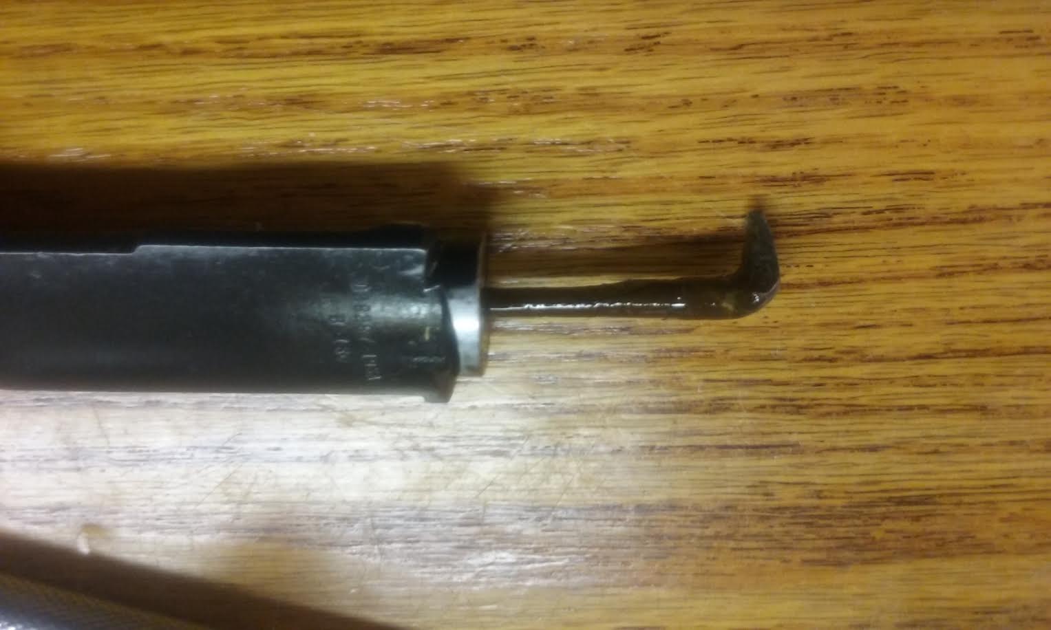

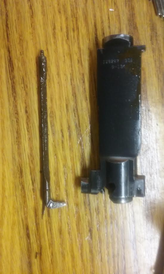

Postby Greg on Sun Oct 02, 2016 4:08 pm
Success!
I managed to drive the firing pin out of the bolt with out hurting the bolt and the firing pin channel cleaned up just fine.
The firing pin has quite a bit of pitting on about 60% of it's length toward the rear of the pin. It should work fine as is but I'd like to replace it to be safe.
Does anybody have a spare firing pin they'd like to sell me?
