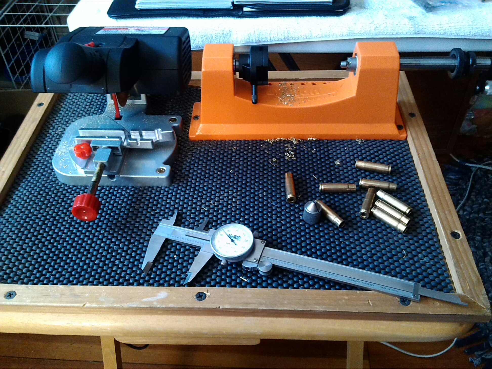

Bearcatrp wrote:Brass made for 300 BO is the same as 5.56 cut down or is it different?
Just looked it up. 7.62x35mm. Was believing 5.56 cut down was used. Guess I missed that in my research. So, better to cut down 7.62 brass or 5.56 brass?
I have never purchased 300AAC, I started making them from the get go. 223/5.56 cut down. The only cases I've had any trouble with has been Seller & Beloit, the
brass seems to be a bit thicker in the neck area so I jest avoid it. Here is a picture of my cutting table. I have barrels in 8.25, 10.5 & 16" running SUB & Supper in all with no
problems now. Had to do some changes on the 16" for the SUB's.

Postby Bearcatrp on Thu Jul 13, 2017 6:42 pm
Thanks for the pic and info. I have a dremmel to cut the brass down. May have to consider something else to cut 2000 of them. About 2000 pieces of 5.56 brass came with the deal. Most are nato. Should put me over for awhile. BTW, are P-Mags gtg or are there better ones out there?
